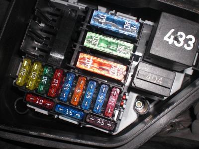

My owners manual doesn't list any fuel pump relays, can you confirm from the picture if the part labeled 433 is it, is the other smaller one 404 for the second fuel pump?

ROW cars have mini relays, look if 404 is a double relay, a wiring diagram should help a lot because the owner's manual is only intended as a kind of first aid and not for more significant problems.

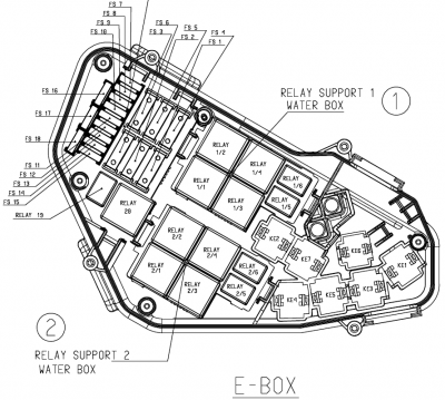

Attached Image: relays_my2005.png
Relay 19 is the fuel pump relay - right
Relay 1/6 is the fuel pump relay - left

Thanks for the diagram.
Ok I have located the relays, now how do I make a bridge and to what pins? How will I know if the pump is working, will it make some sound? When when you say fuel pump relay - right, is this the drivers side?

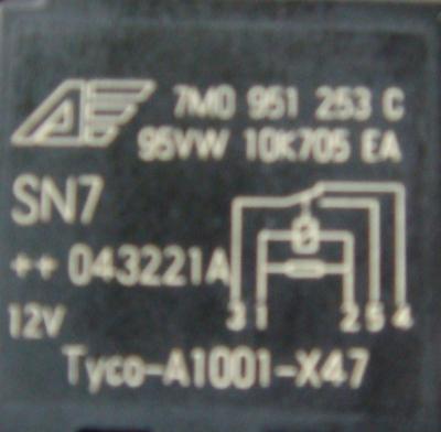

Terminals 3 and 5 with a fused jumper, you should be able to hear the pump run.
#11 User is offline   bigbuzuki
  • Contributing Member
  • Group: Contributing Members
  • Posts: 84
  • Joined: October 27, 2008
  • From:Sydney, Australia
Reputation: 0
Neutral
Posted May 12, 2009 - 07:55 PM
If the pumps do run by jumpering the 3 and 5 terminals, check that the relays are actually serviceable as well by applying correct voltage between pins 1 and 2 and confirming continuity between pins 3 and 5 with a multimeter.

I checked both the fuel pumps today by removing the relays and then supplying 12volt power to the correct points. I heard the fuel pumps go on. I then checked the relays by supplying power to pins 1 and 2, and they both clicked, there was continuity in 3 and 5.
I guess everything is alright here, perhaps there is something else wrong with the car. Any Ideas?
