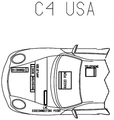

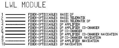

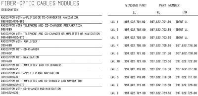

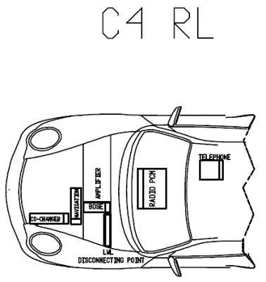

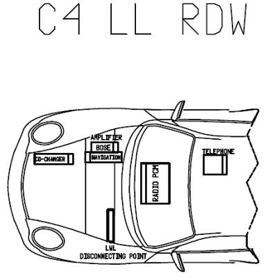

Here is the C4 table of kits for MOST bus optioned cars. You will need to check what options you already have in order to get the right kit. See the additional table legends and locations below.
Attached Image: 997_C4_fiber_cables.gif
Attached Image: 997_C4_fiber_cables_locations_us.gif
Attached Image: 997_C4_fiber_cables_locations_row.gif Attached Image: 997_C4_fiber_cables_locations_row_rl.gif

Attached Image: 997_C4_fiber_cables_routing_legend.gif
