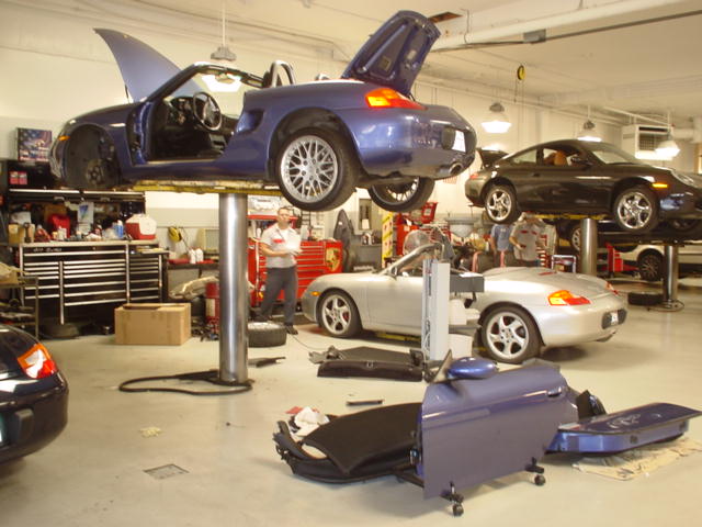

Apparently the problem with the car not running was the DME. When the dealer replaced the DME, the car ran 7 minutes before damaging the replacement. They believe there is a short in the wiring harness and are replacing it. Should be done Monday. Fingers crossed for finally a resolution. Thanks to all who offered help and advice.
More like $8,000, not hours, for the main harness and labor. Took almost a week. Car was taken apart like it was on the factory assembly line.
All because of a repeated air bag light that could not be kept off after several fixes. It was either that, or buy the car back under the Lemon Law.

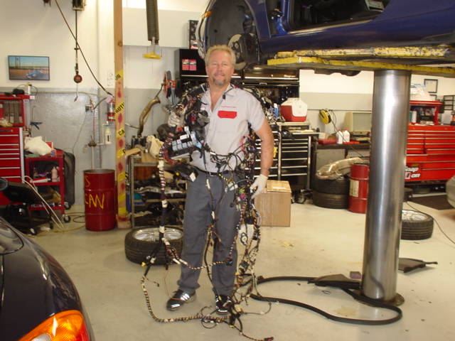

Yikes, that certainly says a thousand words and perhaps launches almost as many questions. I think the final labor is coming in at 36 hours and cost will be $6100 including replacement harness and ecu.
