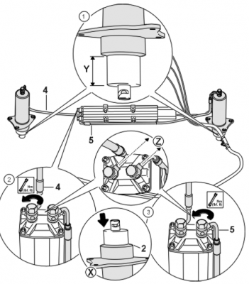

If you do not feel comfortable doing this procedure please take your car to a shop that has experience doing this.
This is straight from the factory manual.
Bleeding the spoiler pump unit
Attached Image: tt_spoiler_bleeding.png
1. Pulling out pump
Pull hydraulic cylinder 2 out to the dimension Y = 35 +2 mm . To do this, connect 12 V to the pump. Observe polarisation arrangement A.
2. Bleeding short hydraulic line
Slowly tighten short hydraulic line 4 until the hydraulic cylinder 2 moves. If the hydraulic cylinder has reached the lower mechanical stop inset X, push back onto the stop if necessary, hydraulic lines must be laid parallel to each other inset Z. Tighten banjo bolt 3. Tightening torque: 15 Nm (11 ftlb.)
3. Bleeding long hydraulic line
Slowly tighten long hydraulic line 5 until the hydraulic cylinder 2 moves. If the hydraulic cylinder has reached the lower mechanical stop inset X, push back onto the stop if necessary, hydraulic lines inset Z must be laid parallel to each other. Tighten banjo bolt 3. Tightening torque: 15 Nm (11 ftlb.)
Note: Use only Pentosin CHF 11 S (or it's replacement).

Where do I top up the pentosin fluid? does it do into the pump or the rams?
The hydraulic cylinder can only be filled in a retracted position.
Position the hydraulic cylinder vertically and fill with 5 ml Pentosin (per hydraulic cylinder) using a syringe.
my spoiler is in the lowered position, is there a manual way of lifting it up so that I can remove the wing and pumps? I've tried putting a 12V supply to it and I can only hear the motor running with no movement.
I also understand that there is a special tool required to remove the rear wing from the rams, is it absolutely essential that I use this tool or can I use something else to substitute.
many thanks
