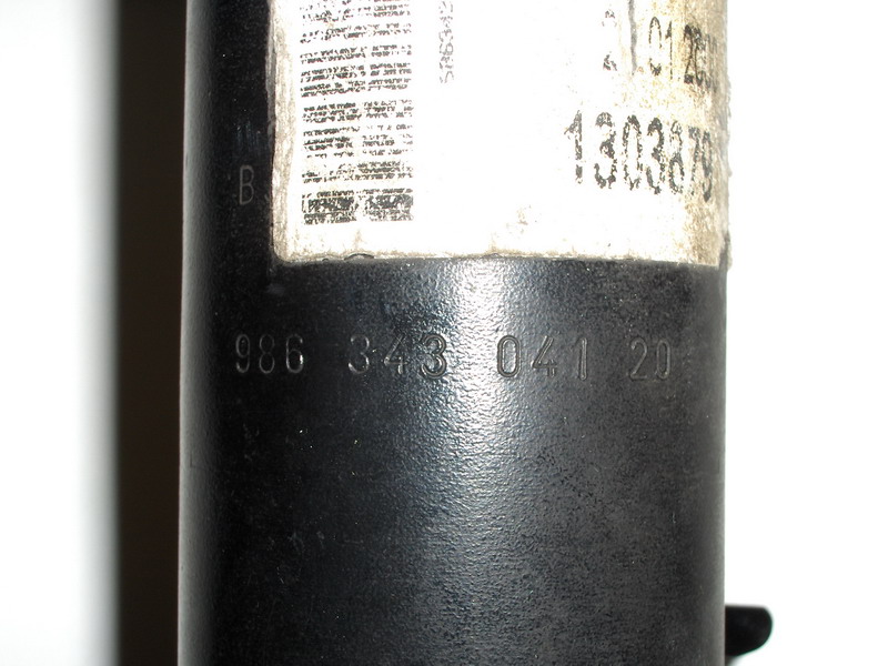

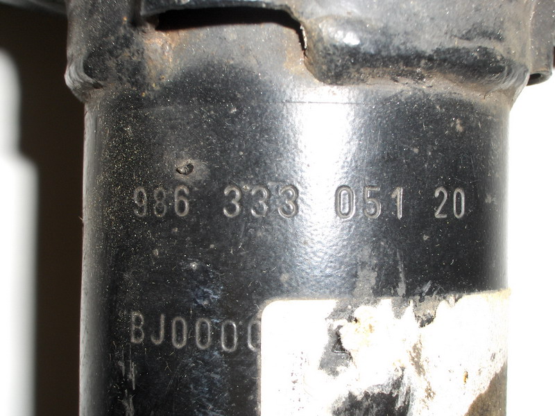

Just looking to verify a couple things here. I bought a "RoW 030 suspension" for a Boxster S on eBay. The guy listed a bunch of invalid part numbers but said everything was RoW 030. Now I get it and I'm pretty sure it's not a RoW 030 kit. Just looking to verify.
He sent:
2x 986.343.041.20 front shocks (part number is stamped on them)
2x 986.333.051.20 rear shocks (part number is stamped on them)
1x 23.6mm sway bar (can't find a part number stamped on this)
1x 18.5mm rear sway bar (can't find a part number stamped on this)
2x front blue/white springs
2x rear pink/yellow springs
Are the springs even 030? The bars don't measure 24/19 like they should for M030, and the part numbers for the shocks I believe should have been:
986.343.041.30 for the fronts and 986.333.051.30 for the rears if they were indeed 030 parts.
Am I correct here? I need all the ammunition I need so I can form a fraud case and get my money back from PayPal. Is there any chance of you faxing the appropriate PET pages to me showing what the correct 030 parts numbers would be or should I just go to my dealer (not usually very helpful)?
Thanks as usual.
Sorry, I don't see anything here that is RoW or M030.
986.343.041.20 are standard front shocks
986.333.051.20 are standard rear shocks
All M030 rear swaybars are 19.2 or 19.8 mm
I do not have sizes for front swaybars
Front blue/white are (US) standard springs
Rear springs - there is no pink/yellow. There is blue/yellow or violet/yellow and neither are RoW M030 springs.

Here are a couple pics of my "RoW M030" shocks :(
I have pictures at home of my calipers measuring my "RoW 24mm front sway bar" at 23.6mm and my "RoW rear sway bar" at 18.5mm :(
