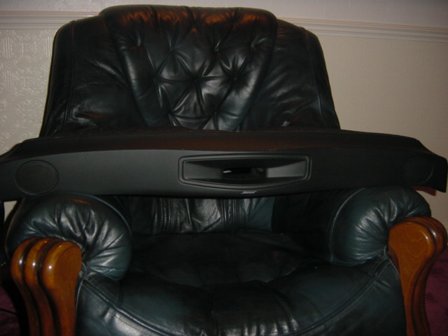

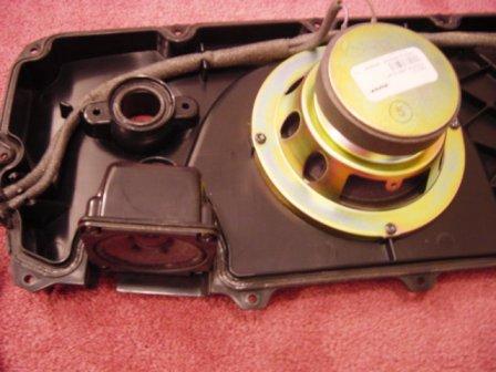

Attached Image: bose.JPG Attached Image: speakers.jpg
i have the bose bass box which i recently i bought from eb*y, i have the front speakers on my car only and a becker tp sat nav which has exactly the same connections as the original porsche head unit.
what i need to know is what harness would i need to connect the bass box to the head, does it need an amp or just a straight connection direct from head to speakers.
here is a few pics of the box stripped down (just the one side) and the connector.Attached Image: connector.JPG
thanks
steve

You Don't need an AMP, I got the cable form my previous rear speaker system, one end go to the Porsche Factory CD or Tape unit and the other end connected to the Bose speakers system connector.
I am not sure where you can get that cable individually, but I know on Ebay, all rear speaker upgrade system came with that particular cable, email those sellers, they may have extra cable for sale.

Burfieldstuff, are those the stock speakers that are in the rear sub? Or are they aftermarket?
I really dont know m8, they are bose speakers in a box designed around the parcel shelf and covered in bose stickers and mouldings.
i have made myself a wiring harness that will connect direct to my becker iso connector so i wont need an amp, and yes i rewired the speakers in series to keep the impedance within my units limits, i got it down to 4.6 ohms by splitting 50% 50%, not ideal i know sound wise but i will give it a go.

Those are the factory/stock speakers. I replaced them in mine with the Focal Kevlar series. Same speakers in the factory door box's and then MB Quart Ref's in the front.
With the factory Becker head unit and amp it sounds decent. 100% better then it was. Have ordered 2 new JL Audio amps and a new Nakamichi deck to make it sound even better.
