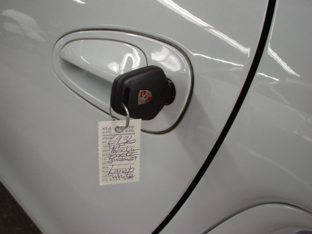

Ok, So I have had my Boxster's console torn apart for a couple days - so I havnt been driving it... Went back to open door, and my Remote will not work (which I am familiar with why). I have only owned this car for like 2 months and I have never needed the manual key. Well the key doesnt work in the door. It works in the ignition. How can I get in my car? any suggestions short of calling the locksmith?

it sounds like the key is not working in the door. is there any resistance when you turn the key, or does it just turn with no resistance at all?

Yeah just resistance when I put the key in the door lock. I could pull the front wheel, but my lugnut key is in the front trunk...
So yeah, the key doesnt turn at all, as if it is the wrong one, but I have no reason to believe that it would be...

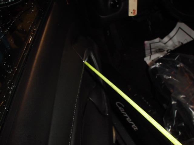

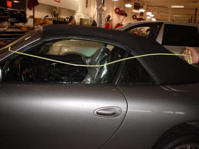

I think the simple method for you is to find a tow truck driver that has this long thing - like a coat hanger from the old days.
This is it on a 996 but the Box is the same. You hook the end of it onto the inside door handle and pull.
will this work on a boxster? since the window slides up into the conv top 'channel', i don't see how he could get that tool in there.

I had no luck with trying to open the door with a metal rod as suggested....

Bit the bullet - called a locksmith. He popped it in like 5 minutes using basically a long rod as shown above. Only $55 and my insurance covers it.

Done and done, now its just time to see why my door lock isnt working... Are these all mechanical or are there electrical components to to the lock???

i'm curious to know how they got that rod into the car. ?
the lock cylinder is mechanical, but i'm sure it connects in some way to electrical components. i was quoted around $250 for a new lock cylinder from Sunset Imports. if you want a cylinder that is ready-to-go (will fit your key) you need to give them your VIN and then they 'key' the lock to your key. this is what i was told by Sunset, anyway.

Inside the door from the key lock is a flat piece of metal, about 3 inches long, it connects to the door lock in the same fashon a screwdriver goes into a slotted screw-its not fixed just pushes in there, therefore by simply removing the door lock- connect the wires back op (with the lock in your hand) you can use a flat blade screwdriver to lock and unlock the car - this should wake your system up.
Next remove the door lock and either get a new one or take it to a locksmith to get it to work with the key you have
Ok - so I tried my key in the console lock also - No worky. I removed the key cylinder and "adjusted it" so now that works. I will probably take the door cylinder to a locksmith fix.
