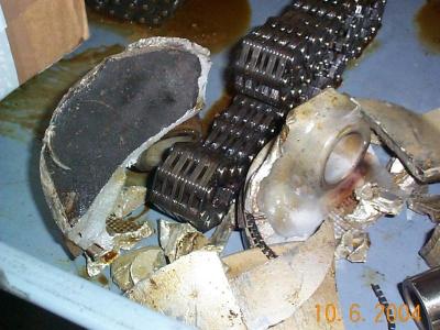

Posted October 29, 2007 - 11:29 AM
 White987S, on Oct 29 2007, 12:12 PM, said:
Tick tock...tick tock.
Boom!

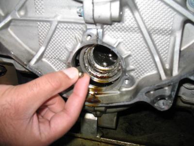

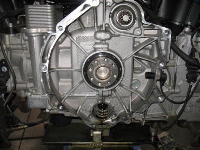

Posted April 19, 2008 - 04:31 PM
I was at a local dealership on a Saturday, so the mechanic working on this car was not around. There is a flange/bearing support bolted to the engine with 3 bolts. In the picture the flange has been removed, but you can see the 3 threaded holes for the bolts. If the mechanic had been there I would have asked to see the flange and the bolt in the middle that shears off.
You can see the balls from the failed bearing.
It was a 2003 or 2004 2.7. Good news is I did not see a leak from the RMS. Bad news is, the owner needs a new engine due to an intermediate shaft failure.

Posted May 01, 2008 - 09:38 AM
Very clean looking engine..was this another low mileage incident where the car is only used occasionally?
