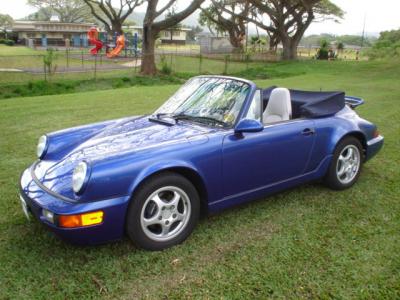

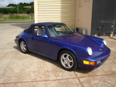

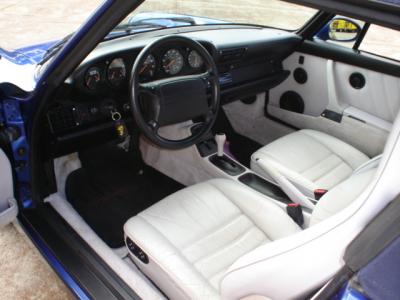

Just bought a beautiful 1992 C2 Cabriolet for my wife...only bad thing is the Tiptronic Trans dosen't work in Manual mode and currently only drives in the emergency 3rd gear mode. Any advice and/or tricks to check and ultimately repair it will be greatly appreciated!!!
This car is a "mini" project for me to complete and for my wife to enjoy driving - Overall the car is in great condition but I am restoring it to almost new. Already began restoration project with all new tail lights, new interior carpet, various seals, various lost or broken pieces, and added keyless entry system. FYI: Other than the Tip not working properly she only really needs cosmetic touching up...at least to my standards. Most of my friends say the car is already in great condition but I really want to make it special for my wife. Especially because it's air-cooled. (FYI: I drive a 99' C4 6spd) Motor is tight, AC was upgraded to R134 and works perfectlty, upgraded stereo, seats in very good condition, everything works as it should, body only has a few dings, need to rapaint the rear decklid, new top installed, ...as I mentioned for how old the car is she is in great shape...just want to fix the transmission!
Thanks in advance if anyone can help me to save money not having to buy very expensive parts unnecessarily. I don't mind spending whatever it takes to get the car running properly...just don't want waste money if I don't have to.
Here's what I did so far:
1. Checked trans fluid - ok (plan to change fluid/filter soon anyway)
2. Removed center console, switches were very dirty covered in old foam washer particles - cleaned off switches - still doesn't work in Manual mode. (Tip Trans light stil lit up) FYI: I suspect the car had some light flood damage at one time due to the interior seems musty..the reason why I am changing the whole interior carpet.
3. Ordered new Tip Relay - wll change this weekend to see if it helps.
4. Plan to check individual switches soon.
5. Ordered 964 repair manual - ...waiting for it! Wish it would arrive sooner!
6. Also, the reverse lights are on when the car is in Park. They go out when trans in Drive. Why???
7. Trans "clunks" into Reverse mode. Suspect a trans mount or engine mount will need to be changed?
Anyway, enough rambling, any help will be much appreciated. JS
