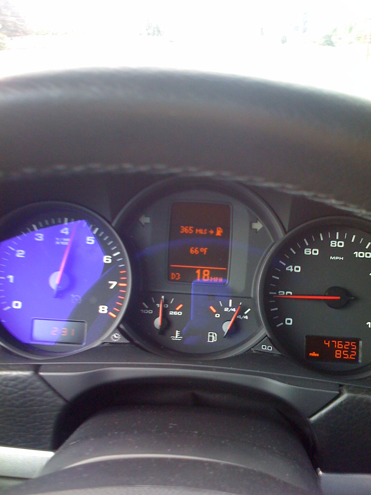

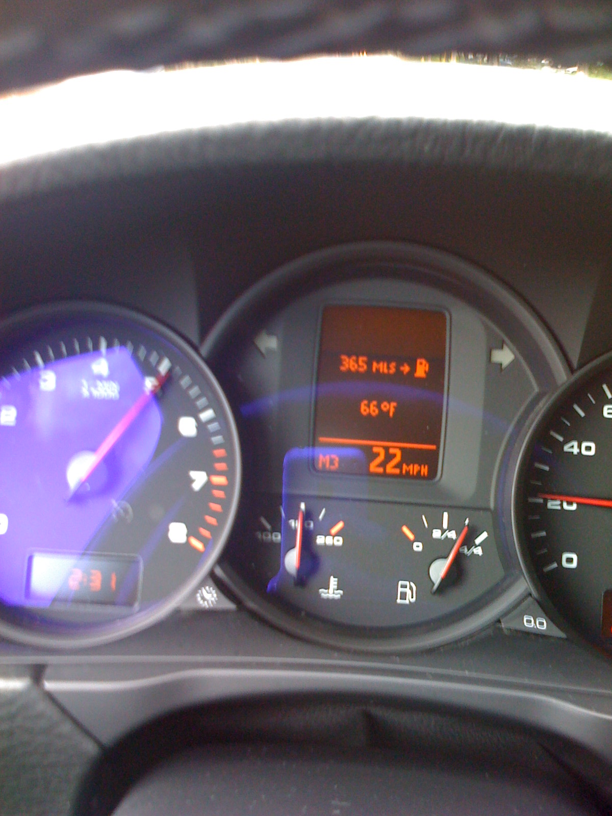

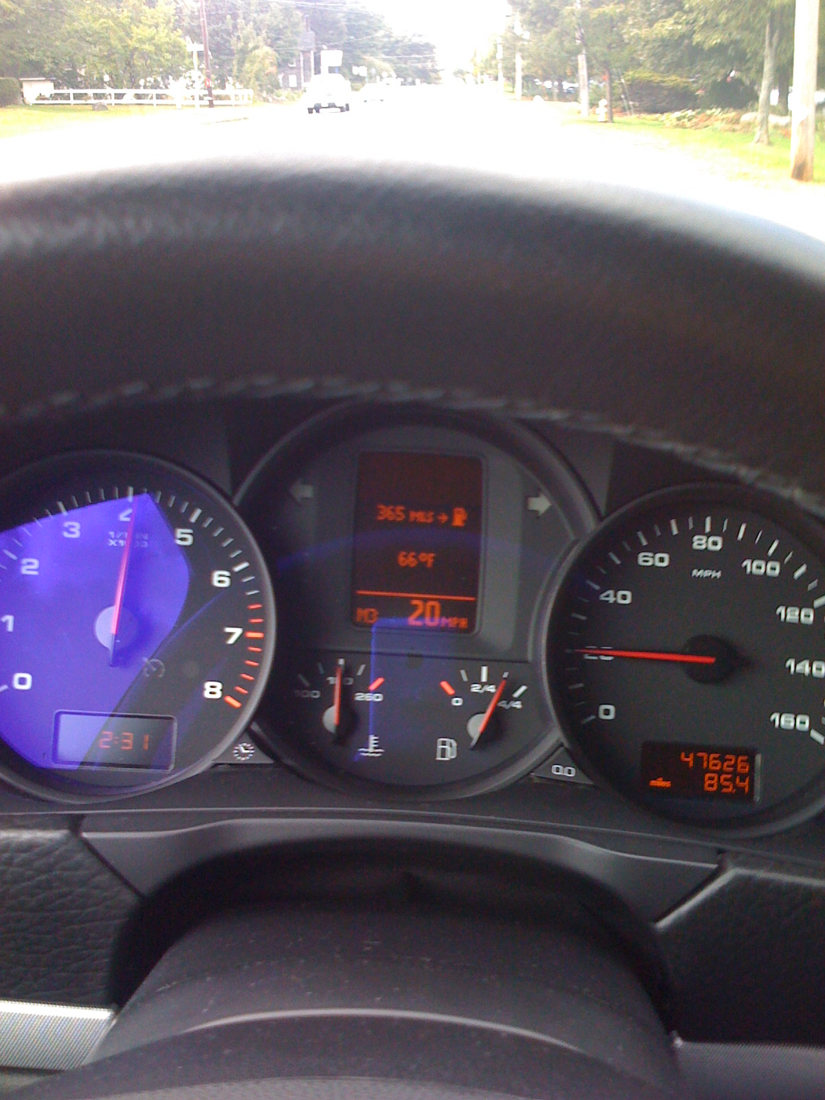

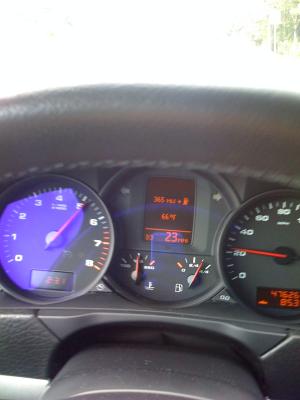

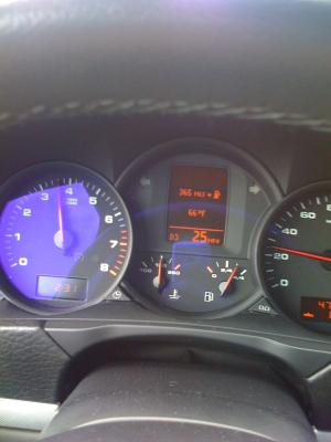

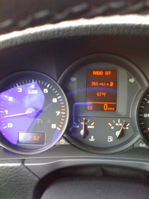

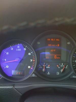

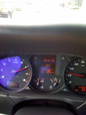

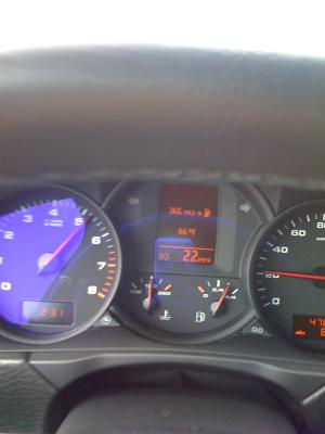

My '05 V6 had a similar problem.
During any slightly-more-than-gentle-but-not-harsh acceleration, the RPM shot to the roof, while the transmission would not up-shift. Even at high RPM (red line) and 3rd gear, for example, the speed would not exceed 20MPH. Usually that ended up in a "bang" which shook the entire vehicle as if it hit a wall, and then everything went back to normal.
However, if the bang didn't occur, the gear would get stuck, even if the vehicle was parked and the engine was turned off. If you check out my attachment, you will notice that the vehicle was at 3rd gear when the engine was off, and it started at the 3rd gear, which I felt like it was really at the 1st gear, as it would not go over 20MPH even the RPM constantly hitting close to the red line. Ultimately, it also needed an automatic "bang" to bring itself back to normal state.
The dealer couldn't get a code, and couldn't duplicate the problem, but they replaced the entire transmission after I showed them 3 video clips of different occurrences, and that solved the problem completely. On the other hand, I was surprised that I was able to duplicate the problem on a '04 Cayenne S loaner that the dealer lent to me during the repair. I think it may not be uncommon.
ps. It first happened when switching down gears manually, but later problems occurred any time the vehicle as accelerated slightly faster, and it would not up or down shift even with Tip Tronic.

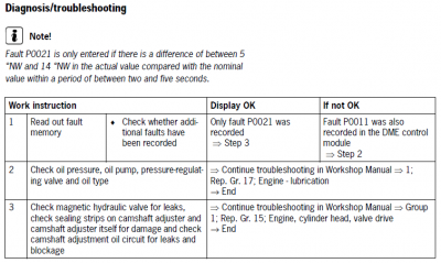

View Posthawkeye651, on Apr 14 2009, 10:48 AM, said:
Hi,
Similar fault on my UK Mar 2005 Cayenne S - 40,000m.
After numerous attempts to diagnose the fault I have managed to capture the following Fault Code on two separate occasions:-
Code P0021 - intake cam shaft adjustment bank 2 implausible signal.
Question - does this indicate a dodgy sensor and could this be the source of the fault?
Grateful for any thoughts.
Thanks
P0021 Adjustment of Inlet Camshaft in relation to Crankshaft, Bank 2 – Signal Implausible
Possible cause of fault
- Dirt in oil circuit
- Sealing strips on inlet camshaft adjuster faulty
- Oil pressure too low
- Mechanical fault in inlet camshaft adjuster
- Magnetic hydraulic valve faulty

Many thanks Loren - will report back.
