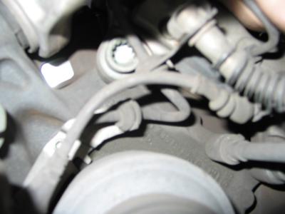

I am also doing the rear brakes and rotors, and it is definitely different from the front brakes. First question, the caliper bolts holding on the caliper are a 12 point star design (ie like a torx bit) not like the front which you can take off with a regular socket.
Do you know what size that star bolt is? I tested with a T60 torx bolt and it is quite a bit smaller than what is needed. and do you know anyplace to buy the required 12 point bit?
here is a photo of the bolt.

FWIW... these bits are called triple square. XZN is the technical designation.
I bought a set of them from Amazon.com believe it or not. I have not used them yet to do the brakes.
Here is a tiny url to the set that I bought.
http://tinyurl.com/o7tw4o
FYI as I understand the torque settings for the bolts holding the calipers in place is 200 ft lbs. Make sure you have a good set of these bits before you apply that much torque to remove them. As soon as I find out what size I need for those bolts I will be buying the snap-on version of that size thanks to the fact their set is 176 bucks!

Thanks. I borrowed one from my neighbor who is a indy Porsche technician. Yeah, the front caliper bolts are 200 ft/lbs. but he said the rears are 120 ft/lbs. I just tried getting either one of the ones on the left side off, and no luck. the bottom one is the only one I have room to really usesome force to get it to move and no such luck. the top one, I can just barely get the bit on the bolt( due to a stabilizer arm or something being in the way), so no luck with even trying with that one. I have all of the parts, so I am going to take them down to their shop and see what they will charge just for the install.

OK, so I did this. I found a special 12pt double square 16bit that was made just for the "VW Oil Pan". It cost me $9 at my local tool store (you can probably Google it). I also bought a 1/2" long handle rachet that allowed you to get to the bit at any angle. Both of these were invaluable...
The rotors came of with a 50 torax bit. There was another screw on the rotor which I have no idea what it does, but I jammed a torax into it and moved it to the new rotor. I think it's an access hole cover so you don't have to remove the rotors.
All in all the rotor change took 1hr with the right tools. My only regret is that the brake cleaner also removed my Porsche decals on the caliper :o(
