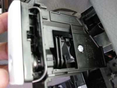

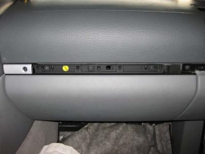

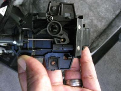

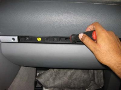

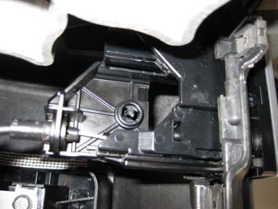

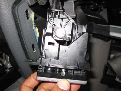

To answer my own question, the answer is kind of silly. The reason the handle (tab) would not slide down because I had the glove box on the locked position so what was sticking out is the locking prong for the locking mechanism. The solution was to put the key in there turn it to unlock position and I was able to slide the whole handle for the glove box.
The problem was cause by a little piece of plastic that acts as the pivot point as the previous poser mentioned, this is a weak design and will fail in most cases. I ended up doing the same fix I drilled a smooth hole to fit a screw in there. I put a washer to allow for movement and an extra nut so the screw won't come loose.
I'm posting some picture
DIY:
You need a T20 torx bit
1. Remove the Trim (in my case it's titanium silver trim) start from the end near the door and pull on it gently it will pop off. continue popping the rest of the tabs in the trim. I used a credit card to help it come off easily.
1.5 if your glove box is not open look for a hole in the middle of where the trim used to be. I think it's the biggest hole available. To open the compartment sit in the passenger seat facing the glove box, put in a screw driver in the big hole at a 45 degree angle pointing downward and to the left. press gently toward the console (like if you were checking if a steak was done don't press too hard as there are other plastic parts that might break)
2. To remove the box there are 3 screws behind the trim that you have to remove. it's Torx 20, there is an additional screw next to the lock of the glove box, and two more screws that are now visible on each side the open glove box, they are inside rubber guards.
3. Look at the bottom of the glove box, there is a screw in the middle that's holding a black plastic cover. Remove that screw and pull the black cover from each end it will snap loose
4. After you remove the black cover there are two more screws that are now visible you can take those off
5. Now slide the glove box off gently rock it side to side while pulling it will come off. be careful not to pull it all the way out there are some wires and the ac tubing attached to the glove box. You can leave those there and rest it on something or you can remove the wires and the tube and put them back on later (that's what I did)
6. Make sure your glove box is on the unloked position !!!! slide out the tab that has the lock where the key is used to lock / unlock.
7. If you are lucky you will have the plastic tab that would have fallen down when the plastic pivot broke. The plastic tab hooks into the wiring that goes to the locking mechanism that holds the latch.
8. All you got to do now is position it back in the middle and put in a screw where the plastic pivot used to be. add a washer and tighten with a nut
You're ready to go. go inside brag to the wife a bit and have a cold one. Sorry if this is too long but I rather post as much info than have you curse me when you have the thing open and can't figure out a step.
Good luck!
