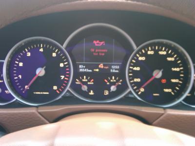

Hi the cayenne turbo instrument cluster is not working the RPM and TEMP Gauges please help sorry for the english.
Thanks

:welcome:
Model and year of your car please?
And... did you install the turbo cluster?

The year and model of my is cayenne S 2006 and i install turbo cluster but i dont know why have this problems :angry:

Did you follow the instructions here

Yes i checked before after do the upgrade.

Sounds like one or more connectors is not all the way plugged in - I would check again.

well, if you own a non us-spec cayenne and if your cluster is from a us-spec cayenne, it will not work.. DME's of the european and us cayenne's are different. I bought a turbo cluster from ebay but it appeared to be from a us spec cayenne, so when we tried to install, we got the same faults as you do. It won't work, don't waste your time, sell it and try to get a proper one.. (i know it is hell diffucult)..
Or if you own a us spec car and got the european cluster, it won't work either as the same reasons above, but i might be interested if you want to sell it. . :)
btw, where did you get it from ?

Cayenne clusters till MY 04 have the "gateway" build in, from MY 05 the "gateway" is separated (under the dash).

i just talked with a mechanic from a p-service, I asked about the same that you wrote, he told that even you have the same gateway version, if the specs are different, it won't work.. what a bs.. :(

hi and thanks, i was thinking about that before buy the cayenne turbo cluster, my cayenne S is european and my cluster is in KM/H and the turbo a buy is in MPH.
the cluster i get is from a cayenne turbo 2004 they was crashed in US today i delivered to NY BRONX to a friend to sell it, if you are interested you can send me a message for contacs. thanks

could you help us in this case. I couldn't get a clear answer from my service mechanics.
I have a MY04 Cayenne S, European Spec..
And daurys cluster is from a MY04 CTT, US Spec.. I guess both have the gateway buildin..
will it work in my cayenne ?
(the service says that eventhough the gateway versions is the same, it won't work because of the different regional DME's.. I'm confused.. :()

According to what RFM said if both are model year 2004 you should be okay.

Hi you think if i buy 2005-2006 CT cluster us spec to my CS european is going to work?

I think the printed dials will be wrong for your RoW car (will show MPH, etc.) so your best choice would be an RoW cluster.

100 % working turbo instrument cluster in my cayenne S 2006 :D :D :D :D :D
