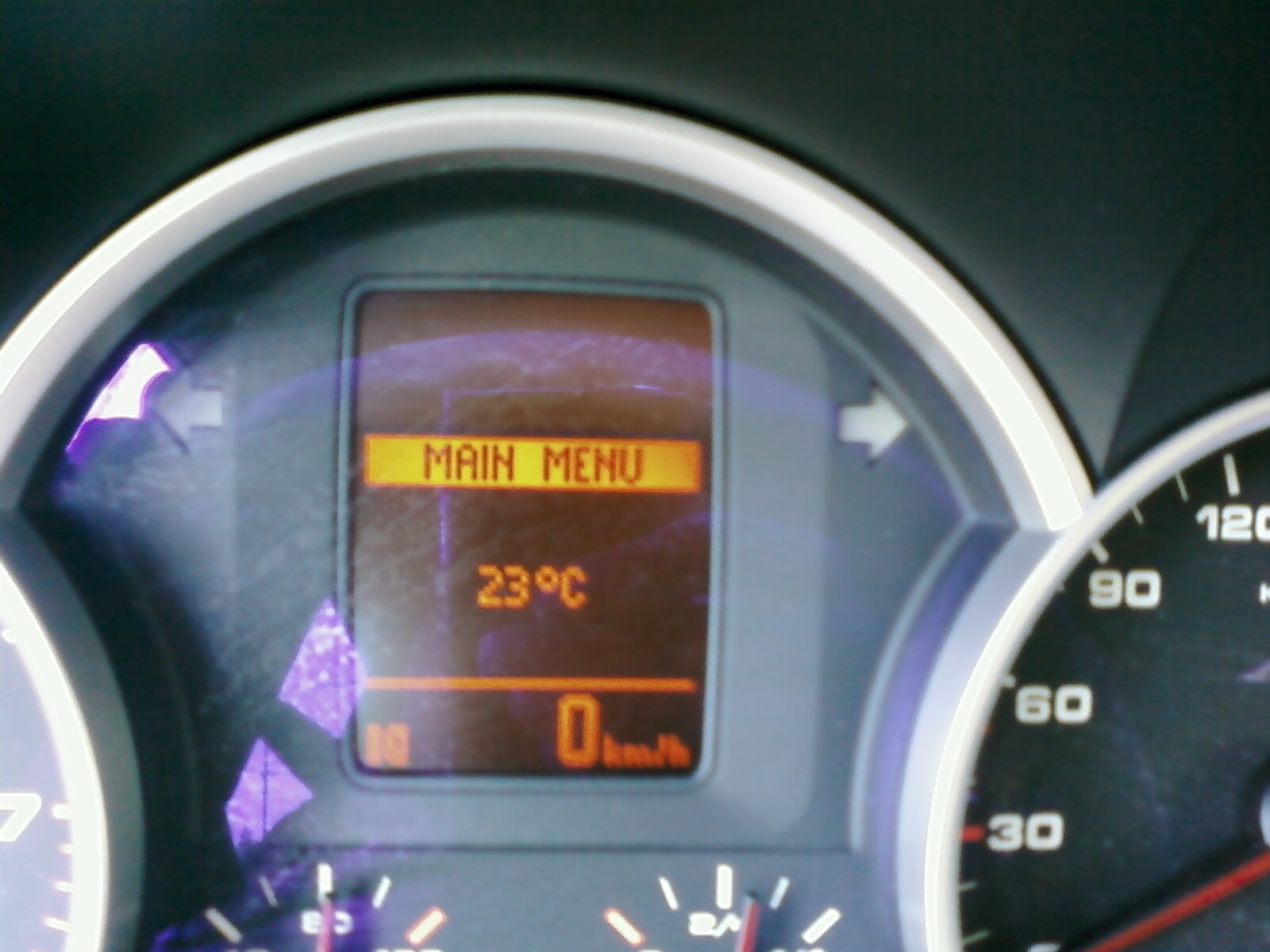

What does this mean? It happens every once in a while (most of the time the display is normal)
Thanks!

Are you asking why it says "Main Menu"? If yes, then you have cycled through the display settings and you are at the on-board computer (OBC) option.

Haha no - I was asking about the D (the section that cycles through your gears, P, N, R) - it usually does that for me, but every so often turns into a solid square with a D in it

Well that makes a bit more sense, its hard to see in the photo. I have seen that before and if my recall is correct it was the display, not broken outside of tolerances, (i.e. no warranty replacement) Try moving the stick to manual and then back again when it does that, to see if it fixes it.
