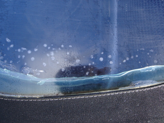

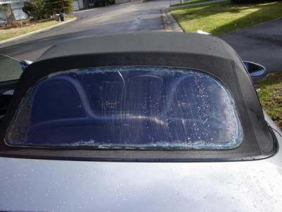

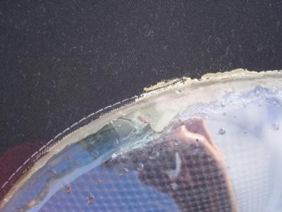

Here's a solution I used to fix my 99' I bought a roll of the window material and made my own. Here are the steps, total cost was less then 30 dollars! First you put the new material over your old window, with a sharpie marker draw an outline to the shape of your window. Next cut out the new window with scissors, you can remove the line from the sharpie marker with rubbing alcohol. Next secure the new window over the old wiwindowith double sided tape, make sure the tape is at least an inch but not too far from the edges. Next use an glue called household goop or shoe goo (same thing) this can be bought at K-mart or most hardware stores. Put a bead of the glue between the old and new window around the edges and allow to dry for atat least days! Than after you are sure the glue is dry, you just cut out the old window from the inside of your car with a scissors, leaving about 1 inch of the old window in place where the glue is. This really works mine has held up for a year now, and looks perfect. one last thing, do not try to add more glue on the inside of the window after the old window is removed, I tried to do this to make it extra secure, and stoped after a few inches due to the bead of glue not looking uniform.
Here are some pictures of my window replacement. These were taken today (about one year after I installed the new window) to show how well it has held up. The last picture is what not to do, I put a little glue on the out side to seal the new window where the old one had broken completely away from the fabric, this was a mistake, the glue after about 6 months or so turns yellow from sunlight, but seems to be just fine aslong as it is protected on the inside, the clear plastic window material must block UV light or something.
