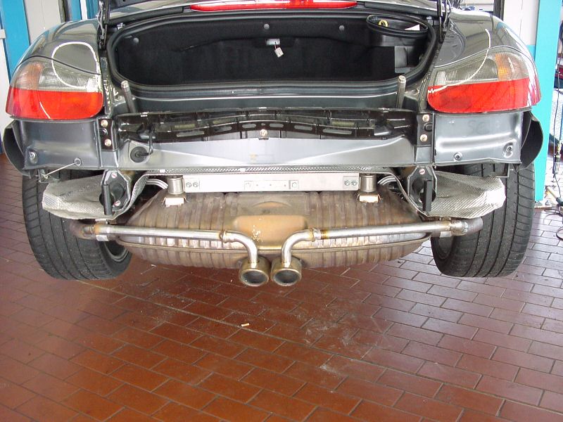

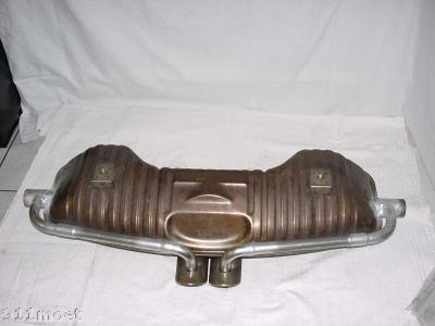

Apparently what they do is buy 2nd hand boxster exhausts from ebay and modify them. They install the bypass vavles as seen on the pictures.

I just asked on one of the German Boxster boards if anyone has experience with these modified mufflers. Interesting how the bypass pipes are located on top unlike the original sport exhaust.

-The exhaust is standard porsche exhaust only modified (the guys buy second hand items on ebay, modify them, then sell them).
-The technical solution (bypass pipes) is clever.
So the car remains standard. I hated the looks of 'shower' OEM sport exhaust.

Eric - it sounds like your long wait has paid off
I too have been looking for an exhaust upgrade for my 2000 S. It sounds like the system you had fitted would be perfect. I would love too have a deeper tone (something like my SSI + modified dual outlet muffler on my previous 911SC would be great) but dont want to have any resonance.
My problem is I live in Australia and freight here is prohibitive so I have been thinking about modifying my own exhaust. Key question is how big to make the bypass tubes. Obviously the larger these are the noise the modified system will be. Someone had a posting on the PBB board and he used 1 1/8" tube but looking at the photos this seems larger than the tubing on your system. The tubing on yours seems to be about 25mm OD. Could you confirm this.
Nifty,
I did not measure it but about 2.5cm seems correct.

You can replace the muffler without removing the bumper cover, but it is easy to remove the cover and you will have more room to work.
Nick on the Porsche Club Great Britain board bought one for his 996, and gave it a good review. The German seller said he can make it not so loud, loud, and louder. I assume this is done by changing the diameter of the bypass pipe. Do not know if you have this choice for the 986
I hope that the unit can be installed without removing the rear bumper and all the related body pieces. Was that just to illustrate the look?
There is no need to remove the bumper cover as in the picture.
There are 2 important points to removing the muffler
#1 - disconnect the exhaust pipes at the SLEEVES between the muffler and cats rather than at the 3-bolt flange. In the picture below - left is good - right is bad
#2 - It is tricky to locate and loosen the TOP mounting nuts. See the two bolts sticking out of the flat bar spanning the top of the muffler? You can see them in the picture but they are not visible on the car. These bolts attach to a large aluminum bracket which attaches to the transmission. All of the bracket bolts and nuts are basically invisible until removed and in some cases you have to reach an arm around each side of the transmission to operate a ratchet wrench with a swivel attachment.
Pictured below is the aluminum muffler bracket for the S. This can be left on the car for muffler replacement. The muffler is only mounted with 4 nuts. 2 nuts are removed at the top(one is removed in the photo) and two screw/nut sets are loosened at the bottom to allow the wire/bar at the bottom of the photo to come loose. These are obvious and easily visible from under the car.

no resonance in the boxster.
when i used to drive lotus elises, i could barely find any exhaust with no booming in mid-range.
No such problem here: remember there are bypass valves added to the exhaust. Meaning that when the engine is under load, then the flow of gas is forced into the 'normal' exhaust (same as standard and not through the bypass pipes), so the noise tends to be less loud.
