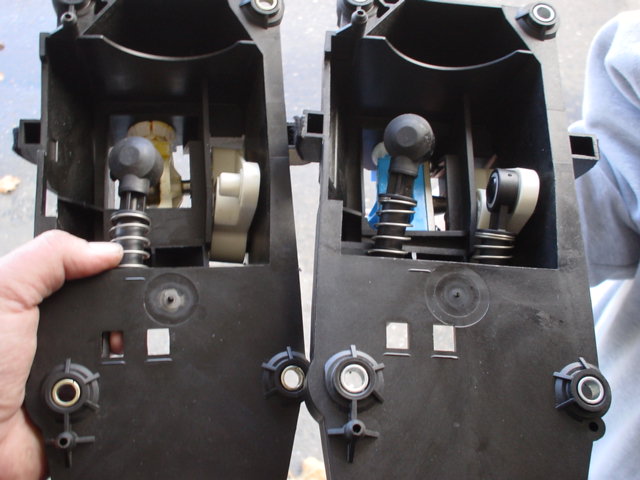

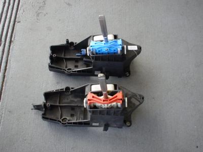

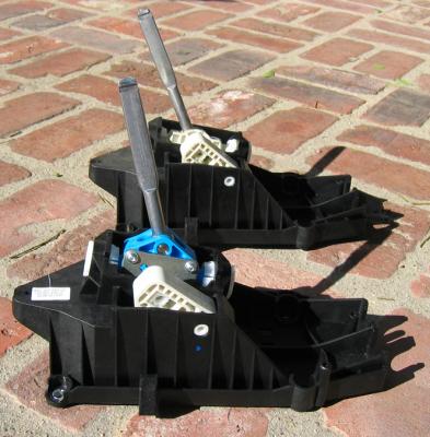

Comparing the original and 997 style short shifters, there are a few differences in the housings, but nothing of any consequence. The new short shifter is tighter in the housing, but I attribute that to almost 40K miles of use on the original one. I expect the shifter to loosed up a bit in a few thousand miles of use.

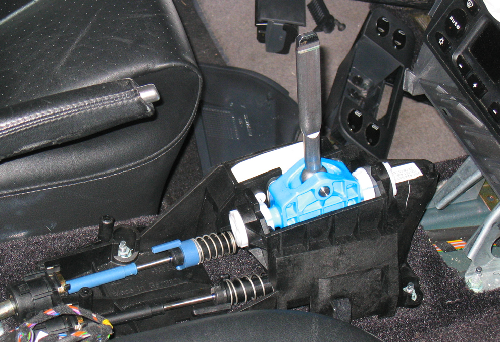

I finally pulled everything apart the other weekend, only broke the part that holds the rear center console alarm microswitch, and finally got everything put back together. The little green mounting plate (986-424-010-01) fit onto the housing, but it looked like a very close fit, so I left it off. Following Tool Pant's advice, I used the Porsche method for transferring the shift cables and kept the ends attached. The new 997 shifter came with the cable ends as well, and I just swapped old for new between the two housings, so no cable adjustments needed.
I measured the before and after shift distance. As best as I can tell, the shift reduction is about 25% (Porsche claims 20% in their ads - http://www11.porsche.com/usa/accessoriesan.../n36/n100/n120/ ). The feeling is almost as smooth as the original, and the shift reduction feels like more than a 25% reduction. To me, it definitely feels better than the B&M short shifter. I'm still deciding if it's better than the original. The biggest improvement I noticed is the 4 to 5 shifts feel better in terms of shift travel distance. Note that because more effort is required to for the shifter, it doesn't make the shifts any faster, just shorter. After driving it for a day, I quickly got used to it and didn't notice that much of a diference in around town driving.

Just a couple more notes referencing your side-by-side pictures that came out better than mine:
The "tail" on the 986 shifter housing serves no apparent purpose. Some cabling comes out of the center tunnel a short distance behind this tail, but the tail doesn't seem to provide a guide or anything. Not sure what it's for, but you don't need it on the 997 housing
On the left side of the new style housing, there's an extra piece sticking up. It doesn't interfere with anything on the 986, and I can only suspect it's possibly used for a screw on the 997.
