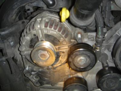

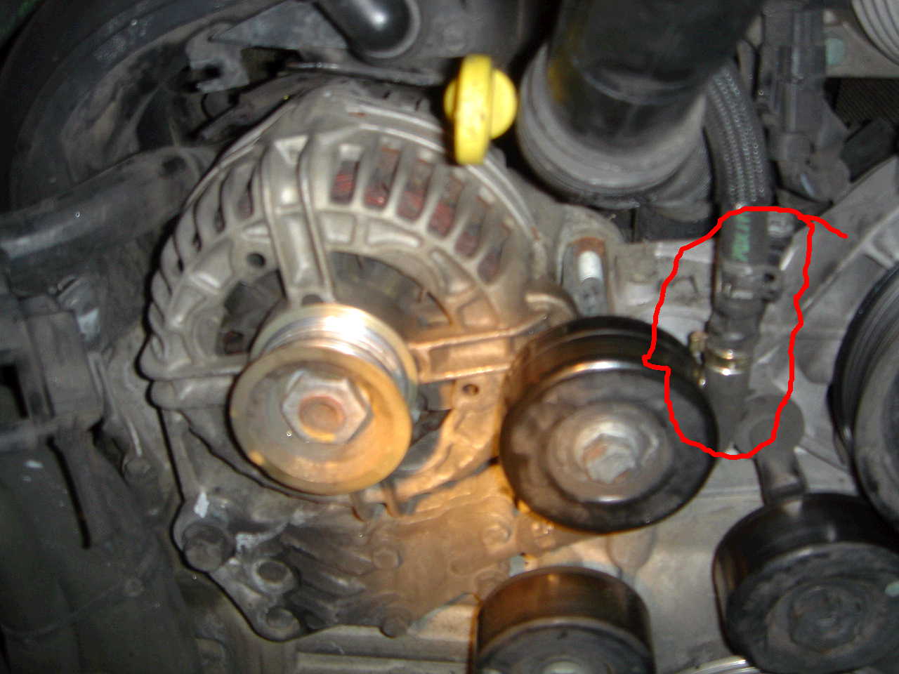

Your description sounds *very* similar to a problem I had on the way to a hearing. Except I had a plume of steam coming from the rear as well. Turns out that a small plastic fitting near the alternator failed. When the engine was running, it was spraying coolant everywhere, very quickly, and under pressure. If you look for the thread I posted in on removing alternators you can see some of my pictures of the general area. The fitting is about a five dollar part but is not, according to my local dealer, an 'in-stock' item. They had to pull it off of an engine that was shipped in to replace a blown one. I'll see if I can find an appropriate pic.
Bottom line, I wouldn't risk overheating the engine. Get it towed to the shop.
... Except I had a plume of steam coming from the rear as well. Turns out that a small plastic fitting near the alternator failed. ...
Take a look at the plastic fitting that is just right of the idler pulley. See the small hose feeding into it? Its full of pressurized coolant. The fitting failed and spewed coolant *everywhere*.
