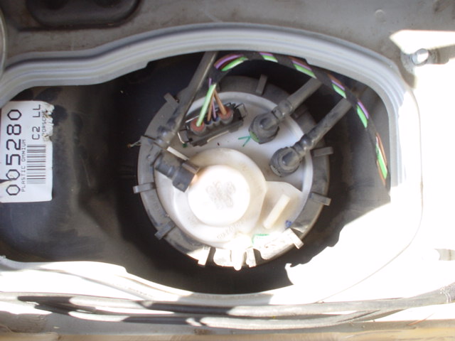

Remove the battery and the 4 nuts for the battery tray. This much I have done. The pump is under the battery tray. First picture is my car from a few years ago when I looked to see what was under the battery tray.

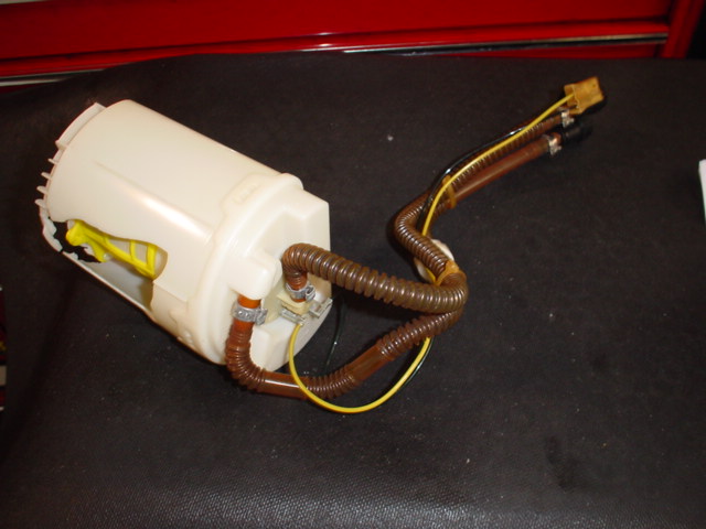

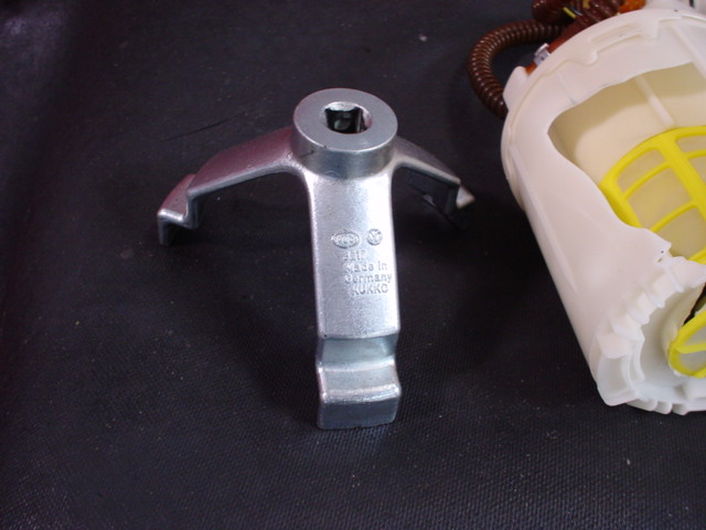

You need to unscrew a plastic locking ring to get the pump out of the tank. The tool is a VW tool but if you are creative I bet you can remove the locking ring. This picture and the last picture were taken at my dealer last year after a fuel pump was removed, I think to replace the sender unit.
The fuel level sender is the white portion you see looking down on the tank in Tool Pants first picture. Removing the pump is a pretty straight forward job. Remove the battery and tray and the black locking ring. Then you can pull the sender up and out of tank. Once you remove the fuel level sender you can look into the tank and see the pump is twist locked to the bottom of the tank. Reach in and you'll be able to unscrew it. You wont need to recalibrate the fuel level sensor. When you do reinstall the fuel level sender take care to line up the marks on top of the sender with the mark on the tank, otherwise the float will hang on the lines.

Why does the picture of the fuel pump look like its cracked open? is that some sorta mod?
I do not think this has been covered before, and I have not done it.
