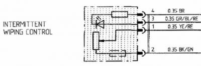

I just found this on the internet. I was wondering if anyone can tell me which pins on the connector are 1, 2, 3, and 4. Also, can anyone verify the colors of the wires you tap into. Thanks! :D Pin 1 Yellow/Red (Relay Pin 1) 2 Black/Green (Relay Pin 6) 3 Blue/Green/Red (illumination) 4 Brown (ground)

Here is the picture of the connector and wiring diagram - this should help a lot (note the 4 on the plug). wiper_delay_connector_Loren.jpg

Thanks Loren! So all you do is hook in the relay, then tap the 4 wires into the corrosponding wires in the main cable harness. The only question I have left is which place do you put the relay in?
