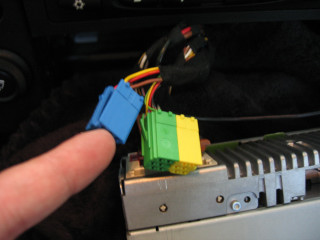

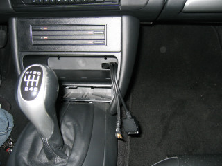

I installed the following cable in my 2002 C4S : http://www.discountcarstereo.com/detail.aspx?ID=1010
It works fine and it does charge the ipod.
First I removed the cd changer.
This cable replaces the cd changer cable in the back of the radio.
Remove the blue plug and replace it with the cable
In order to charge the ipod, you need to plug it on 12v... (marron for ground and orange for +12v so it does not stay on when you turn it off)
Then remove the cd holder to have space and install the cable properly
One nice thing about this cable is that it has a jack so you can plug a garmin that has bluetooth and then your car has bluetooth...
In order to avoid noise (which is really minimal but you may hear it between two tracks) I added a noise filter (12$ from cruchtfield).
One very important thing : when you unplug the cd changer, you may loose (I did) the AUX on the radio... no need to go to Porsche... press the TP button for 8 seconds, then you will access the program menu of the radio, turn on the AUX and you are good to go!
