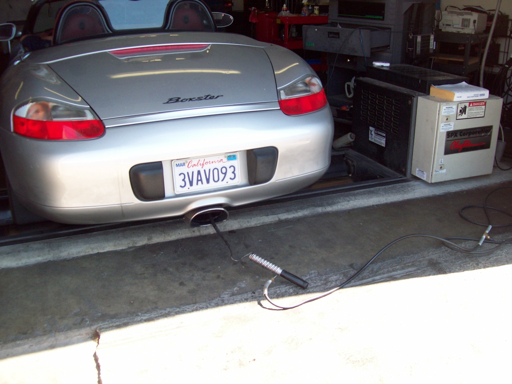

The Box gained no weight. It was 3,125 pounds at the test facility I went to on December 7, 2007, and the same weight at a different facility that I went to today.

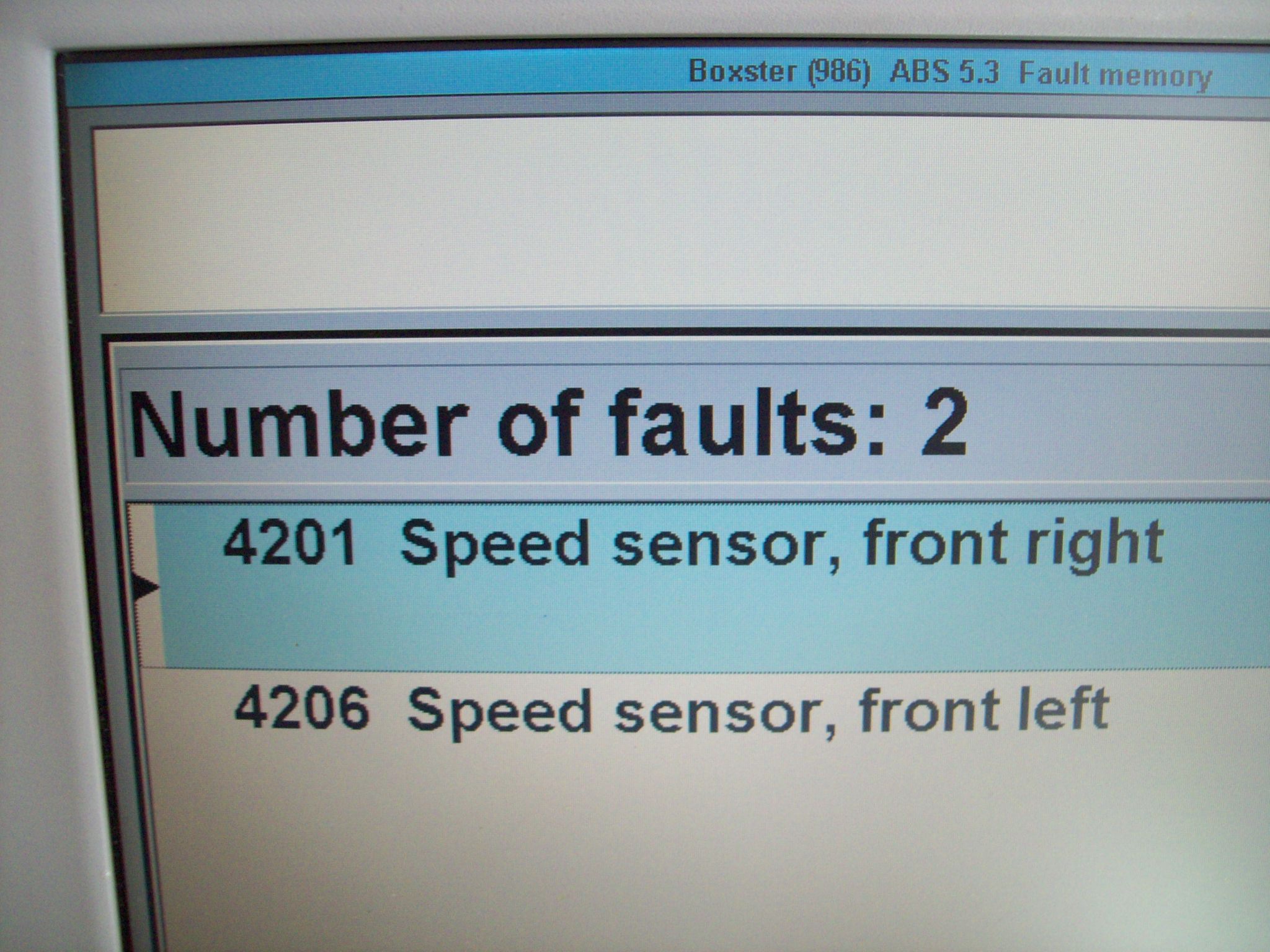

I had the same ABS front wheel sensor faults that I had at the last inspection. This is because the rear wheels are spinning on the dyno and the front wheels are not moving.

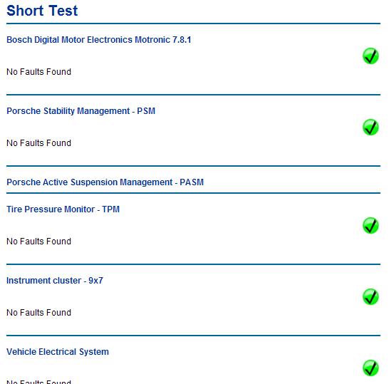

I'm suffering from Secondary Air Readiness not complete on my 07 Cayman base model with 100k miles.
I replaced my faulty DMTL pump 3 weeks ago and have since driven the car around 200 miles, with about 30 cold starts. There are no codes at all in Durametric, and I have done several long drives with the speed under 3000rpm. I also scanned the car with a Snap-on Modis and it reports the same. No fault codes but SAI not ready.
The only symptom I have is that the fuel tank is difficult to fill without the pump clicking off all the time.
I need to pass smog so I can re-register it, but I also need to replace a failing starter motor, for which I need to disconnect the battery, which will reset the DME, so I won't pass smog...
Any ideas on how to get this thing to pass Secondary Readiness.

The SAI system is notorious for this "fail" problem.  As you have a Porsche diagnostic tool, the first thing to try is activation of the SAI pump using the diagnostic tool. If it does run, you need to start checking all of the valves in the system as one may be stuck or inoperative.  This system is always a bit of an "Easter Egg hunt" when they act up.  I would also think that your refueling issue may not be related to the SAI fail. but caused by a issue in the EVAP tank venting system, which again is a common problem area.
Both of these areas have been written up previously, so I would start with a cup of coffee and a search for some info.
