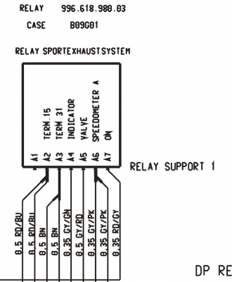

You mean the 'pins' on the relay I assume? Yes - I plugged the relay into the socket, then read the numbers off the relay. Here's what the relay looks like:
Note: What concerns me are the words ' realign socket contents' - I assume this means move wires and lugs right? Then 'realign jumper plug in relay carrier 1' Jumper Plug?
I assume that the 3 small square lugs go to terminals in the empty carrier below the relays.

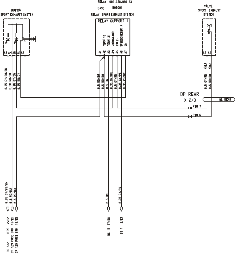

Here is the PSE relay wiring diagram (for MY04) - match this and you will be fine.
Thanks Loren - I'll have a look at the relay etc.
On first take, the new diagram seems to be more like what I have.
So, was I correct in assuming that 'realign' meant 'move' the connectors on the supplied relay socket?

Thanks - I think the last diagram answered my questions. My confusion came from the apparent need to reterminate the ground for A3 (the other end terminates on the relay block ground I guess)and to reterminate the gy/pk wire for A6. (I'll do this even though I don't plan to use the gy/pk wire).

Pressing the switch does not engage the system- system is installed per the above diagrams and I have verified all connections between the relay, the dash switch and the changeover valve. Switch has backlight, LED lights when switch is pressed. Changeover valve appears to be correctly routed between the engine and the exhaust actuators. Actuators engage when attached directly to vacuum.
I am mystified. The only thing the I did not connect is the pink/gy wire per Loren's prior suggestion. When I feel like dealing with this again, I guess I will attach that wire and see what happens.
Thoughts anyone?
Can you diagram how you did wire it?
Wired per diagrams you provided in post 2 and post 8. FYI I did not use the relay diagram that I drew after reading on one of the other PSE posts that the diagrams referred to the numbers on the Delrin router base. I will edit that diagram per notes as soon as I can.
I was very careful to verify that there is a hot lead fuse 10, row B -to the changeover valve and to the switch and relay and that ground is good.

Here is the complete diagram for a MY04 Boxster.
The switch was not an option (nor was there a diagram before MY03 - but I know folks have done the same switch mod on older Carrera's.
Thanks - that's the diagram that I used. (That and the enlarged one above).
Do you think the pink/grey connector is an issue?
I had planned to install as you suggested - without it so that the switch would effectively just be an on/off switch.
When I have some time, I'll remove the relay block again and have a look - unless it's the pk/gy wire, there's got to be a reasonable explanation. The only one I can think of now is that I could have swapped RD/GY for GY/RD at the relay but, I was very careful.
