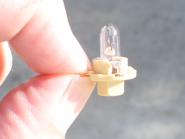

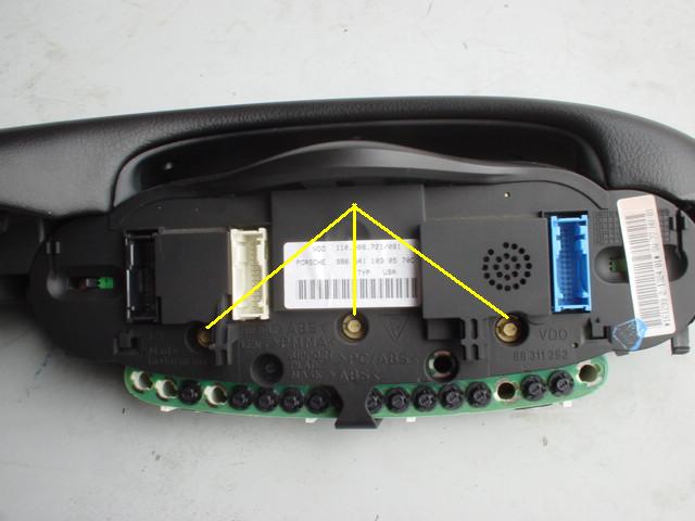

I'm a little confused as to how many bulb there are per LCD display. I see it mentioned that there is one per LCD display (total of 3), but the pictures indicate there could be more. Without having opened-up and instrument cluster, its hard to determine exactly how many bulbs there are.
This picture looks like there is only one per LCD display: post-1862-1222282273_thumb.jpg
But in this picture there appears to be 3 bulbs just for the center LCD display: post-1862-1222282409_thumb.jpg
This is being made way to complicated for the LED disply bulbs. Part number is 999 631 303 90 and they are 1.5 watts.
There are 3 bulbs for each LED, and I have 3 yellow lines going to them. They are on the back of the cluster and the cluster does not need to be opened up to replace them.
There is a row of 1.2 watt bulbs in black holders on the outside of the cluster, but they are for the idiot lights.
There are also bulbs inside the cluster, but they have nothing to do with the LEDs.

Just FYI, I just replaced the one of the bulbs in the instrument cluster. The left most bulb, which illuminates the odometer, went out a few weeks ago. The rest of the instrument panel lighting was OK.
I used this link for instructions to separate the instrument cluster from the car. I actually did not need to remove all the wire connections to completely remove the cluster from the car. There were four wire connections to the cluster.
http://boxsters.addr.com/hacks/cluster.htm
I didn't have to open up the instrument cluster. I just used a flat head screw drive to remove the bulb in the back of the instrument cluster, then put in the new bulb. That's it.
This is a 99 Boxster. Hope this info helps.
