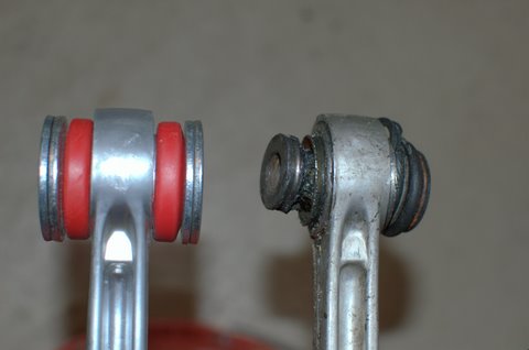

Here are two pictures of the Vertex Control arm replacement and the OEM part with the rubber boot removed. I installed one/ right side to resolve a clunking rattle. I also "did" the boxsterfarher fix but in my case it only worked for several hundred miles. I believe the swivel joint in the arm was well out of spec. Hence the nail punch fix was ineffective.
Installation was a bit harder than the OEM (which is a very easy) as the bushings in the Vertex arm do not flex (L/R) so alignment of the bolt thru the joint into the captive nut required some persuasion .post-6095-1244927741_thumb.jpg,post-6095-1244927760_thumb.jpg

Nice post...please post a follow up about their relaibility..thanks.
