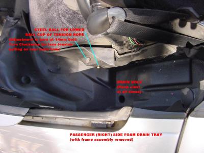

I posted a couple of photos on Mike Focke's web site in a section for cleaning out the drain holes, here: http://mike.focke.googlepages.com/drainsdiagram
Also, here is a nice clear photo of the drain on the passenger side (disregard the other notes). You can see the drain hole just below the "DRAIN HOLE" notation (click on the photo to get it blown up to the right size):
Let me know if you need anymore, and be careful to keep an eye on that water intrusion if that turns out to be from some other ingress.
Regards, Maurice.
