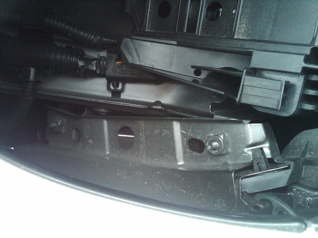

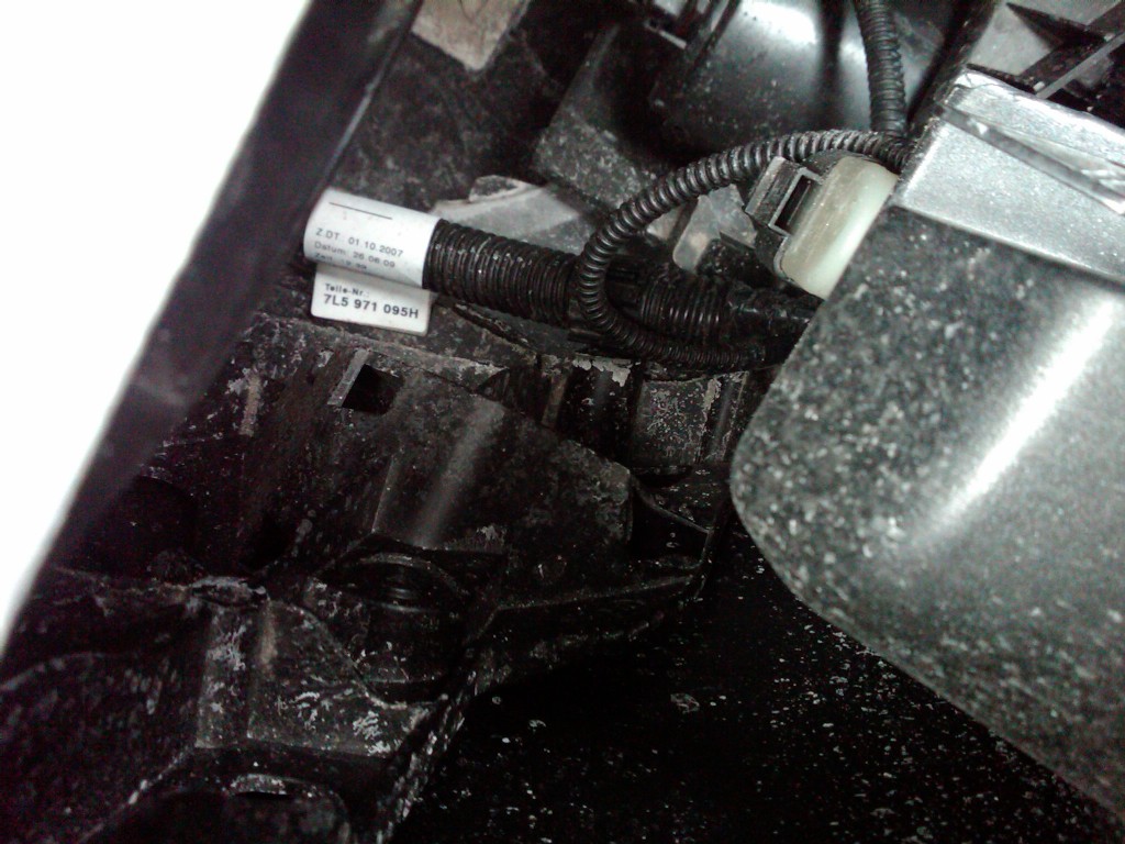

Last set again to keep in one thread. Let me know if anyone has questions about what the shots are, I tried to get all the connection points... This is a 2010 Cayenne v6
thats awesome! thanks.
the plugs for the front lights look a little diferent. I couldnt see from the picture, but does this V6 has Xenon lights?
also, funny, the V6 doesnt has that coat under the front hood, to keep the noise at lower levels - didnt knew that.

This car has just halogen, no xenon.
Your welcome. Yeah some say they dont like the rear bumper, it is growing on me. Still not sure on the front yet. I need to look at the rear light harness too.
