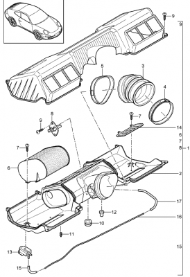

Looking for detailed instructions for changing the air filter of the997-2 with illustrations if available.

Is there any torque requirement for the filter and cover screws (items 7 and 9), or just go for reasonably tight?

Just reasonably tight

Here is the process illustrated for those who are interested. Attached File  Replacing 997.2 engine air filters.pdf   433.05KB   1051 downloads

Awesome write-up!! Great pictures...

This is an excellent guide, but I have a 2007 997-2 and there are no eight screws present to remove the air filter housing. Do you have a similar guide for replacing the filter on the 2007 997-2?

A 2007 997 is a 997-1.
Look at the two DIY Tutorials here
