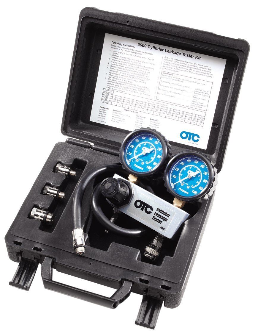

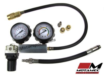

I finally managed to do the test! I did the test at around 80-90psi. I have bought OTC leak down tester. Which did not break. First one was Performance Tools brand and that one broke almost immediately. They are little different but end result is the same. Performance tool tester show loss percent OTC shows pressure so you have to do the maths to know loss percentage. I liked the OTC tester a lot more because there is no need to calibrate pressure to zero. I find it difficult to get the needle stuck on 0. I added some pictures. The one with the blue gauges is the OTC 5609 the other one is an identical leak down tester from another brand but the same as the PT.

I get 5 percent or less on every single cilinder except one. I tested the bad cilinder 3 or 4 times and i get a loss from about 9 to 10 percent. 10 percent would be good if every other cilinder gave 10 percent. I did not hear any noise that i did not hear from the other cilinders but i think i saw some bubbles in the coolant, i'm absolutely not sure about this because it was very little and i did not happen again.
So i'm still not 100% convinced that changing head gaskets will cure my problem.
Using a combustion leak detector as Binger proposed might do the trick. I guess i'll have to go buy one. Or does one say go ahead and get the heads off? 7 cilinders say 5 percent leak loss 1 says around 10.

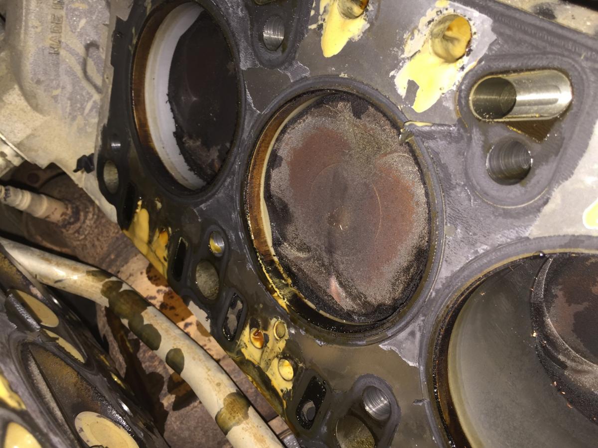

I added some pics. I can't really tell one place where the gasket is damaged, seems like it was leaking everywhere.

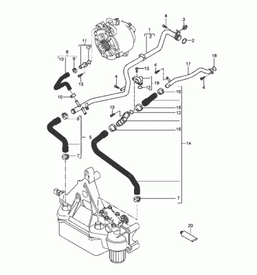

Thanks man, i got the first head back on and the second off. Both heads tested fine. Both gaskets were gone. Fan has been repaired. Just waiting for seal and coolant vent lines which were broken. Coolant to alternator line was broken as well but i can not find the partnumber for that. Does one have this partnumber?
You can download the Porsche parts catalogue, in German-English, from http://www.porsche.com/usa/accessoriesandservices/porscheservice/originalparts/originalpartscatalogue/
Select Cayenne from the Model drop down and then pick the Year and click the Display button, the site then sends you a PDF file, roughly 22Mb.
The link above is for the North America model versions, I don't know whether South America has the exact same build specs.
Edited by liam_b
For OEM parts I use Sonnen Porsche a lot and usually the cheapest for dealer items: http://sonnenporscheoemparts.com/partlocator/index.cfm?siteid=215405
If I'm just going with an OEM supplier like Bosch, Lemforder, Mann, etc... then I use many others including:
www.autohausaz.com  good for Bosch and others
http://www.rmeuropean.com/
www.ecstuning.com
