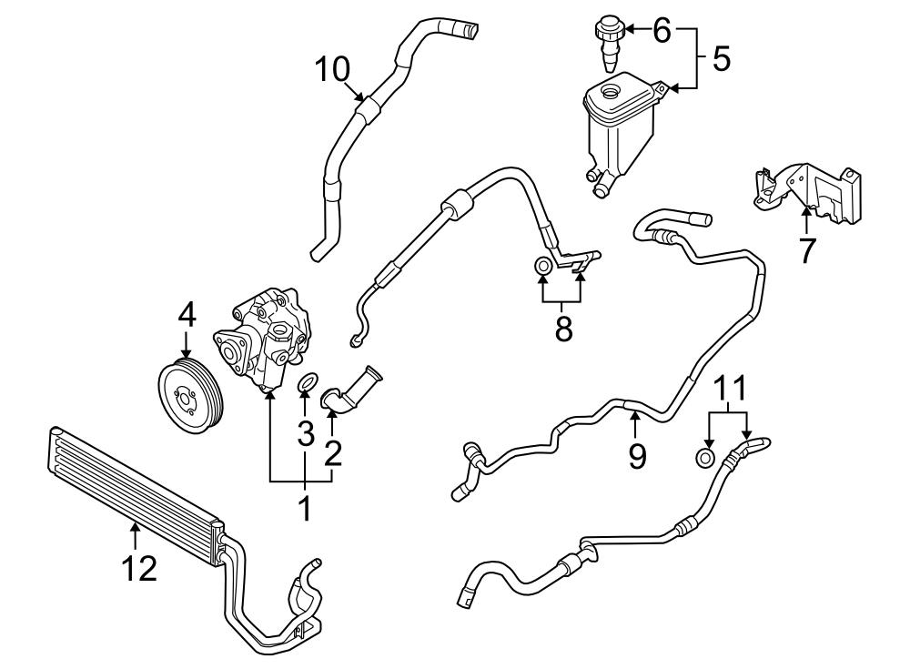

The cooler is a $200 part at retail (95534706903, item #12 below), which makes fixing it economically questionable as you are going to need to get it out of the car to do so, and most of the cost in getting at it in the shop is labor.
Porsche uses their own style clamps on these lines, which I do not believe they sell separately from the hoses.
