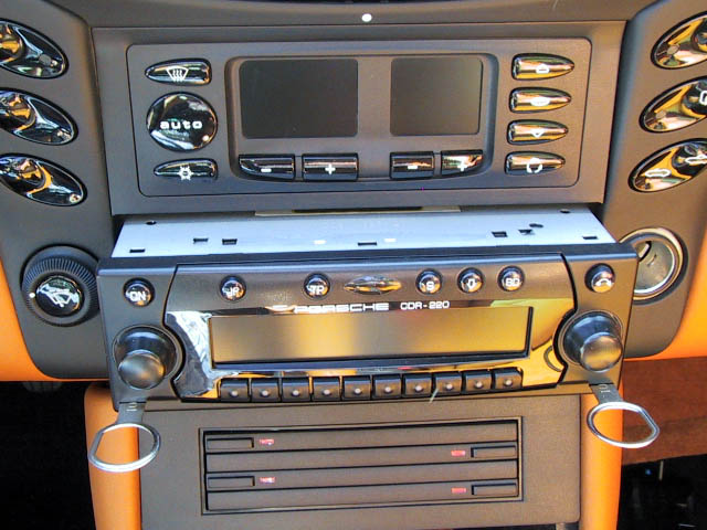

Anyone have any idea, how my radio display would suddenly disappear on my 996 ? Please see my above previous issues. Thanks Britdave :help:
And the model number on your radio is?
I'm not sure Loren , where can I find the radio model number at, do I need to remove it ?
The car isn't here right now, so I'll have to get back on this. A friend mentioned the display could be fused ? Remember its just the radio tuning display that suddenly vanished, all lights out ? The radio/ CD player is the standard one that came with the 2002 996's the display flap comes down to insert a CD, then you push it back to close it,  and just standard speakers came with it, not Bose.
As I said previously, this all occurred after a few days at the body shop, where they removed the left rear side interior, to repair the damage properly over the left wheel well, and quarter panel.  I also found out the drivers seat was never removed, yet the airbag lights still come on when the car is started, and at first the radio didn't come on at all ? Radio/CD plays now, but just no display ?   :help:  Thanks Dave.
