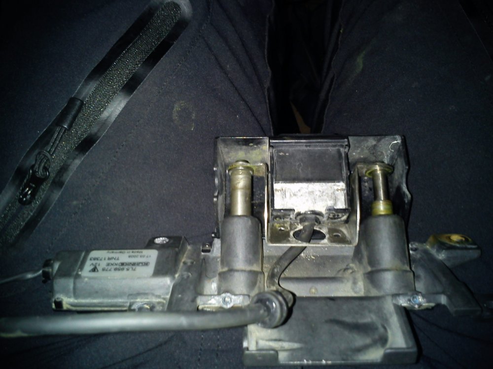

i removed the camera and taked some picture. the mecanisme is " no end srew" who turn for exit or enter the camera. under two cylindre it have two copper cap that i can remove cause the rust. mine is broken and i will completely desasembly it if i find a new camera. maybe that will help someone. it seem that a lube is no efective for this systeme. the door just follow the camera

That is exactly how the '06 camera is, same part number.  I just removed the pieces you show there and cleaned them, re-greased them and put them back together. You have to adjust the screws so the cover opens and closes flush with the trim piece. Is there actually a broken piece in there or can it be cleaned and re-greased?
im not sure if it broken but two side don t move in same position and top srew always loosing. i think that is broken because one cylinder is loose and other is tite. my cover is blocked because the cam move not correctly. now im in search of new cam (by new i men use ). if i find it i will completely disasembly for investigation...
