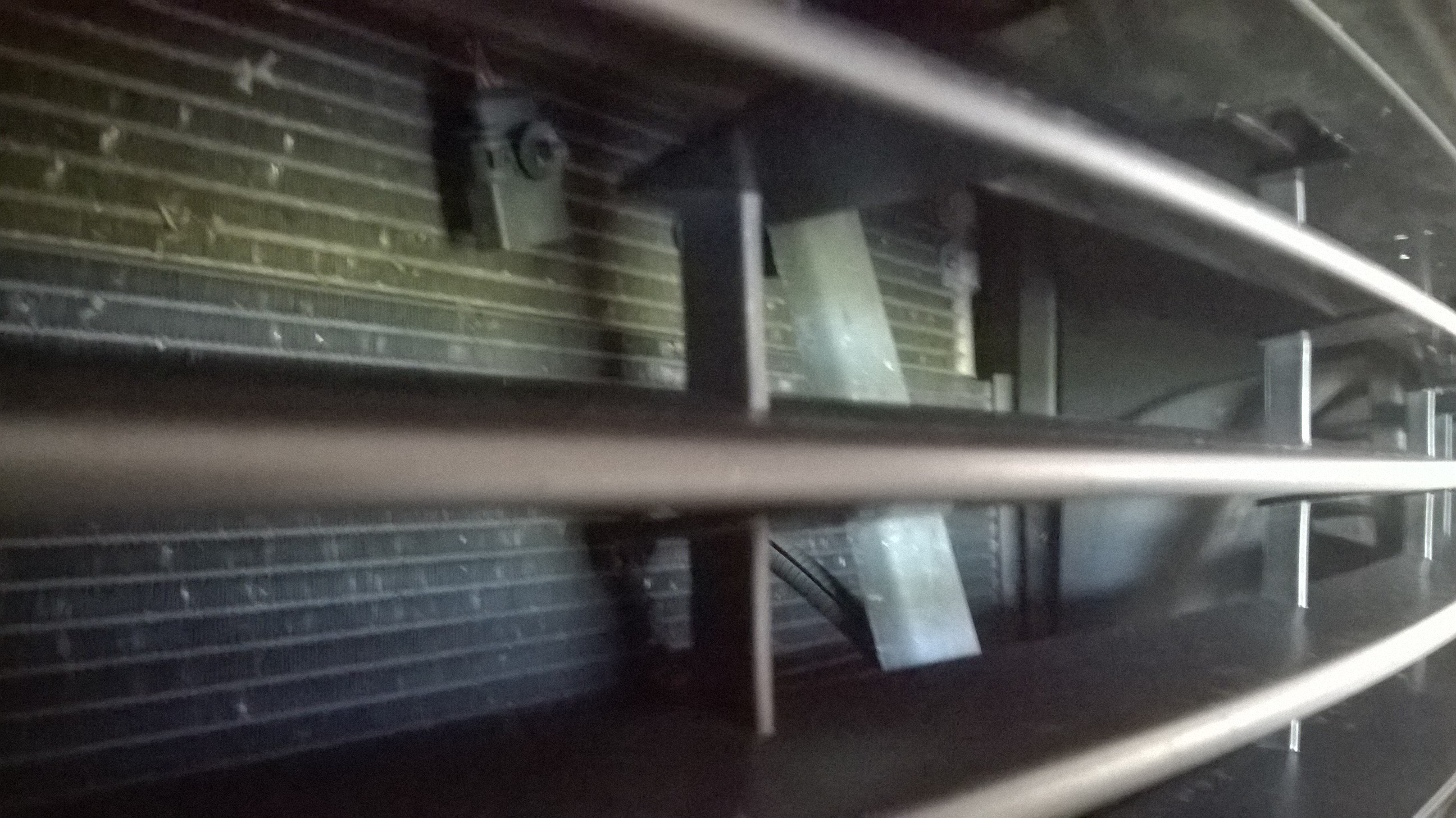

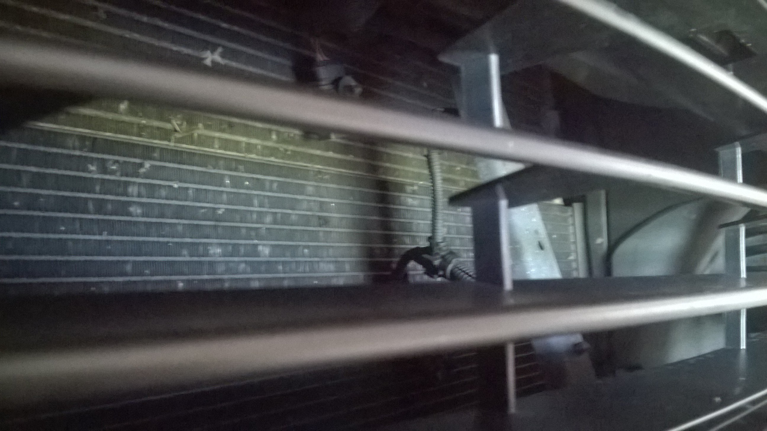

when changing a light bulb to prep the car for the annual garage check I noticed a loose cable roughly in the middle of the grill in front of the radiator. No error messages on the read out of the car. No warning lights. No discernible function as such.
Who can help?

added location picture
2 minutes ago, RFM said:
It could be connected to the engine hood lock, for the indication on the display " Engine Hood Open" This is my best guess honestly. Give it a try.
This is what I thought at first too, but no indications on the display, no error messages or beeps, nothing when reading out the computer via the plug. Only error I am getting is an alarm error.

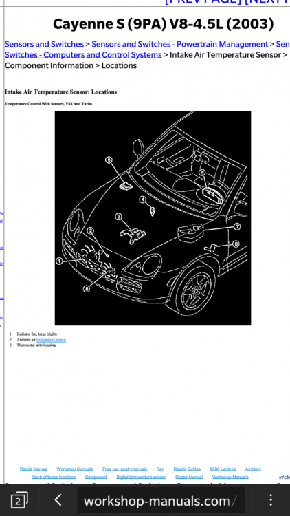

I would go for the ambient air temperature sensor. Item 2 in the Porsche manual for a 2003 cayenne. What does the dash temp read?
Temperature sensor is accurate and works fine so it isn't that :( it is 32C outside and the temp reads 31C so you can't ask for more than that ;-)
2 hours ago, Cayenne955_NL said:
I think that sensor is the thing pointing up which still has power and is on the main cable coming from below
Only other possibility as I can't see any parking sensors is either the bonnet latch micro switch (alarm code related maybe) or the front fog lights wiring harness?

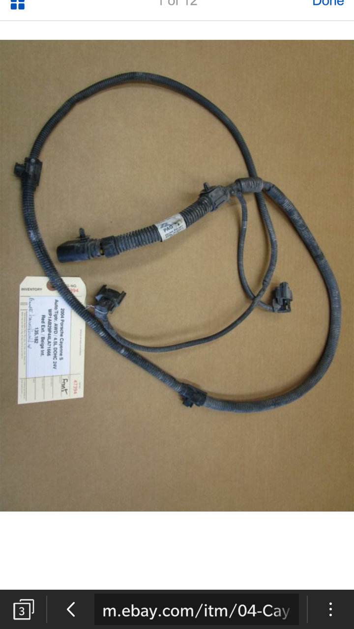

That is exactly what the cable looks like! Front fog lights both work. No parking sensors on the car. So must be related to the bonnet switch?
Yep bonnet switch then, I found a porsche 996 or something bonnet micro switch with harness and plug, the plug looked exactly like the one you have hanging from the top disconnected so I gotta say it must be. Strange the dash doesn't warn the bonnet is open being as the plug is disconnected? Maybe open circuit it doesn't see it as a fault weird no fail safe?
