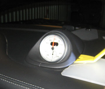

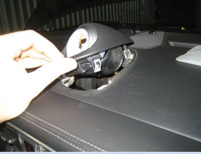

I found the reason for the rattle in my case ..... it is the chrono watch which is not firm enough inside the pod.
I have not worked on it to fix it, but at least I already know how to remove the chrono watch unit. The pod is only snapped it into the dashboard, so with a pry tool it can be taken off.
That should be also a backup solution in how reaching the area behind the center air nozzle.
Will try to get the rattle fixed during some boring day in winter.

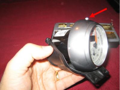

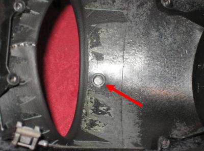

Rattle problem is solved. :clapping:
One of the two pins of the chrono watch had too much clearance inside its hole on the pod.
I fixed it by placing some cloth tape in that hole, so it reduced the clearance.
