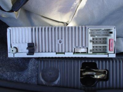

It's a CDR-220 stereo (CD player, with a mini 5-disc changer below it). Fuses in the box on the driver's side floor look OK. I have not pulled the dash apart yet; was hoping there might be something simple like a relay for both of these items... Nothing else appears to be unpowered, just the stereo and lighter

I would also check the back of the radio for loose connections.
