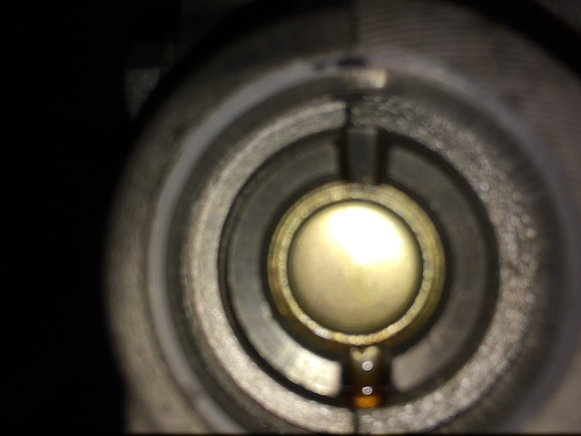

Checked the cam timing and both banks are on the mark aligned with the timing notches while flywheel at TDC.
Plugs: No oil, no foul firing signs, looks they are in good shape (approx. 20K miles on them)

Yes, I confirmed the exhaust cams (with the notches - 5 chain setup) were at 90 deg. How do I check the inlet ones? Do they have position indicators?

Be careful ! Read the Pelican diy article.See links in link below. The INLET cam notch is 90 degrees(??) you mean 3 o'clock.
The Exhaust half moons should be vertical AND align with the parting line of the cam cover with the engine at TDC
But make sure you understand the small but vital difference between the reference positions on Bank 1 vs.Bank 2.

I am trying to understand how to check the inlet cams timing and position indications
On the exhaust side, yes the notches on the cam are vertically aligned with the notches on the covers.
I will now look into the DIY link and check the inlet cam positions.
I will come back with my findings. Thanks!

I have checked the timing visually using the helpful post here: http://986forum.com/forums/performance-technical-chat/26418-diy-setting-cam-timing-m96.html
I did the procedure once and all seems correct on the car. I will be doing the procedure again tomorrow and will post photos so you can confirm my finding.
