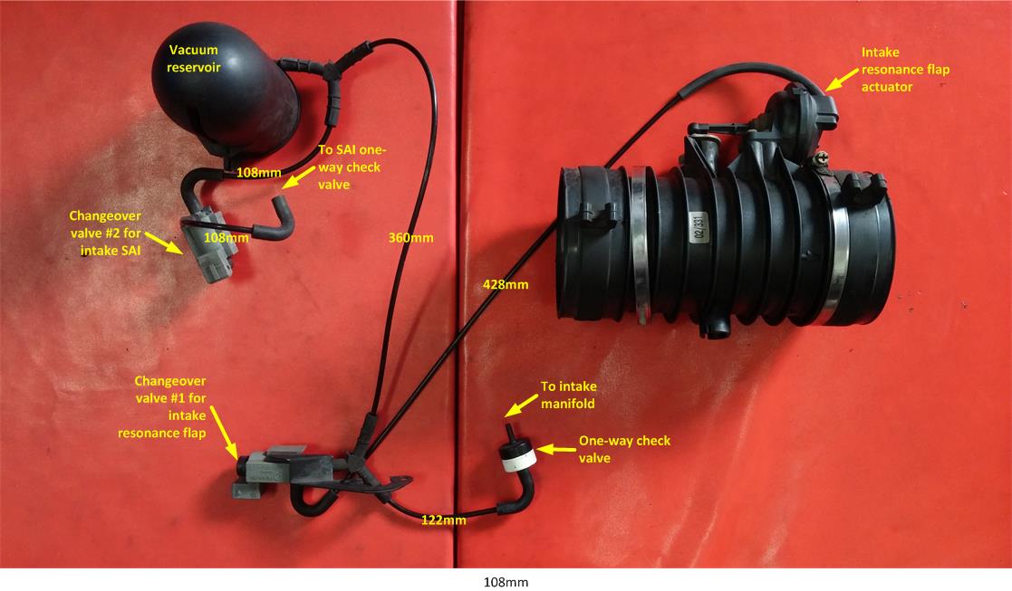

I have an iphone.  Maybe I'll look into the wireless adapter.  I think my next step is to replace some components, as I'm thinking I have a vacuum leak.  I've looked at your thread here:http://rennlist.com/forums/996-forum/849770-mkii-996-vacuum-line-routing-and-related-components.html which is quite helpful.  My check valve does of some oil mist on it, so maybe it's gone bad, but that could be a coincidence.  I'm having a bit of trouble finding some of the components in the Porsche catalog though.  I've found this diagram which shows some of it: http://sonnenporscheoemparts.com/parts/2002/Porsche/911/Carrera%204/?siteid=215405&vehicleid=44889&section=EMISSION%20SYSTEM But I can't find a diagram that shows the parts closer to the throttle body.
Best parts diagrams are on autoatlanta.com You should find all the parts you need here
http://www.autoatlanta.com/porsche-parts/996-99-05/porsche_911_parts.php
Yes, I think it's wise to just replace all the vacuum components including the vacuum reservoir since the parts are relatively cheap and they are prone to leak anyway. You can eliminate a lot and has a good chance to fix the problem too.
For iOS, the OBDII fusion app is great for daignostic purposes. Hopefully you could catch the problem in action e.g., if you hear the pump running but yet the O2 readings don't drop, you know the exhaust is not getting the injected air, which points to a vacuum/valve problem.

Good news, it's been 3 days since I replaced everything, and no CEL.  It seems to start quicker, and hold a more steady idle.  Even better, I passed emissions today!  Thanks for the help Ahsai!
I replaced everything seen in your pic:
896507d1419269132-mkii-996-vacuum-line-r
Except not the plenum or resonance flap actuator.  Also, the dealer only gave me 1m of line, not 2m, so the 122mm bit is still original, but that's the easiest one to replace later.  Also, I mis-counted the number of elbows needed, so the elbow to the one way check is original.  Again easy to replace later.  For anyone doing this in the future, you need 5 elbows, not 4.  While I was in there, I replaced the starter.  I also replaced a couple hose/line holders that I had broken previously when replacing the alternator last year (maybe 2 years ago).
The angle looking at changeover valve #2 is just right so you can't really see one of the elbows.  Circled in Blue below:
post-68261-0-97041100-1437594085_thumb.j
It's a little confusing ordering the parts since the diagram that Porsche uses shows the old style shut off valve from 1999 which has a bit different plumbing.
I am in the process of replacing my Air/Oil Separator and snapped/broke the hose/line that you have marked 428mm.  For the life of me I cannot find the part number.  Can you point me in the right direction?
I think it's 4320501
