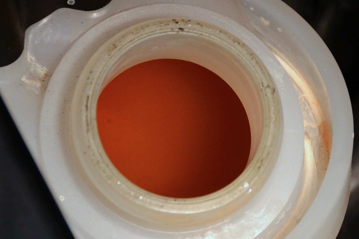

Just had my Tiptronic serviced along with a new water pump. Is the fluid in this picture consistent with the original (or new) Coolant. This is a new (to me) 99 C2 tip and I hadn't noticed the color in the reservoir until yesterday. It doesn't feel like oil when I dip my finger into it.
It looks like the newer "pink" coolant. As it is hard to tell from the picture, is the mixture clear or cloudy?
If you didn't request complete coolant change, only 2 gal will be drained when replacing the water pump and there are total of 6 gal in the system. So if the original coolant was there and they added 2 gal of 50/50 diluted pink coolant, that color looks about right.

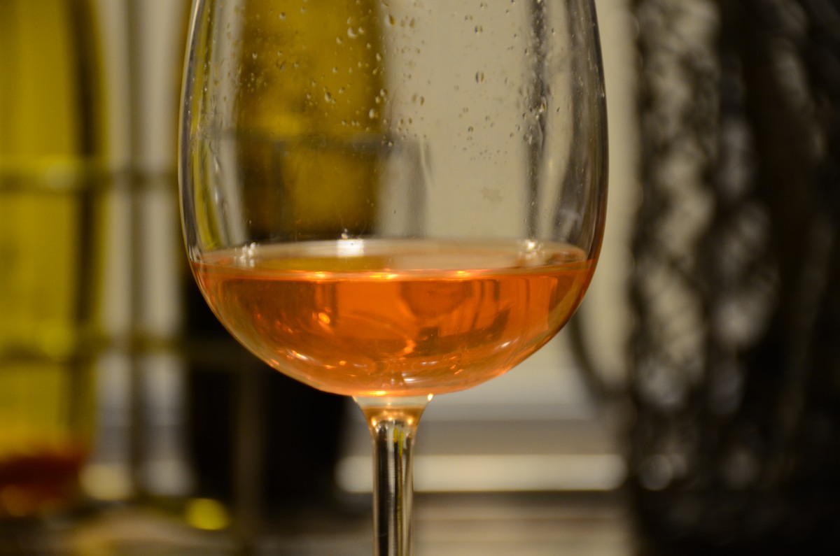

thanks for your help on this and the other thread. I remember now the mechanic telling me the anti freeze was permanent and didn't need changed so that makes sense. Here is a shot of the liquid out of the tank and it's clear with no separation. I'll have my guy look at it in the am just to be sure. I'm sure there is no oil involved looking at this (whew!)

Looks good and you're welcome. I would still recommend a complete coolant change sometime if you still have original coolant from '99 though.
That is not the original coolant, the 1999 stuff would have been green. The pink stuff dates to 2004-05 introduction.

That looks fine, no signs of cloudiness or seperation.

Right and since his coolant is not pink, there may still be some old green coolant mixed in there. It's hard to tell how much though from the photo.
