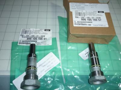

When my 1999 996 sits for a week or so and isn't driven, I get a brief moment, maybe 1 sec where I can hear what I think is the cam chain at a cold start. I know tappet sounds and I don't think that's the issue.
So I ordered two new tensioners, 1-3, and IMS (not 4-6 too hard to get to for now) to see if that fixes the issue.
I was expecting to receive the updated style which had the exterior spring. These ones don't have the exterior spring.
Did I get the old type? Or has it changed again?
The attached pic shows I received parts 996-105-186-01 and 996-105-180-57. Correct part number but old part sent?
Doug
post-54417-0-82635200-1333475561_thumb.j

The thread was confusing to me, and to the posters who participated in it as well. I knew I had the most recent part numbers, according to that thread, but the TSB and the thread referred to an updated tensioner that had an exterior spring. JFP noted in that thread the exterior spring was the new design. And mine did not come with a spring. That's the issue. Is mine an update of the updated design?

That said, I think Logray went through this dance and found out that some parts had been superseded yet again so God (and Stuttgart) only knows what the latest parts are. Suggest giving Jeff at Sunset Porsche (board sponsor) a call, he is usually up on the latest changes
From what I can tell, the latest greatest IMS tensioner is updated from 996-105-180-56 TO: 996-105-180-57. That's what Logray concluded last June in the thread referenced above.
But, the big question I have is, I thought the newest design(s) were supposed to have a supplemental exterior spring to increase the chain tension when there is no oil pressure present, such as a cold start.
Do not use -55 or -56 (one with external spring). They are designed only for the non-roller (hyvo) type chains. The reason why Porsche moved to the hyvo chains was apparently to reduce chain noise. There's nothing wrong with the old roller chains (in fact I tend to believe they are stronger, even if they make more noise).
You should ONLY use the -54 (supersceded to -57) tensioner. Unless you have torn your engine apart and replaced all of the components per the TSB referenced above then you can use -55 or -56.
There have been reports of people trying the -55 or -56 tensioner with the roller style chains and having problems with that combination. You should not attempt that combintation since other people have already tried it without success.
If you read the TSB it clearly spells out the -55 (supersceded by -56) is only applicable to the updated hyvo chain.
The -54 (supersceded by -57) is only applicable to the roller chain in your engine.
I have the -57 in my 100% rebuilt roller chain engine and it makes absolutley no startup noise whatsoever.
You will see that -56 is NOT superceded by -57. 996-105-180-56 is still orderable today (and not replaced by a different part).
In fact, -54 was still orderable up until a few months back when I ordered mine (the confusion in that thread was because I managed to order it before it was inserted into PET, it was a very new part number when I ordered it).
Edited by logray
OK, got it. I have the original roller type chain, so the 996-105-180-57 is the newest tensioner for my car. The exterior spring style tensioner is only for the later tooth type chain. I thought maybe the dealer had sent me an old part since it lacked the spring, and I didn't want to miss out on all that bonus spring goodness! I plan to install this weekend while I change my oil.

OK, changed the oil, and filter and the 1-3 and IMS tensioner yesterday. I did not change 4-6 since it is a hassle to get to. At initial start up there was no noise!
That's encouraging since those conditions replicate a cold start after the car has been sitting for a couple of weeks, almost.....Almost because I had driven the car one week ago. Usually it has to sit for a couple of weeks to hear the noise. And if the 4-6 tensioner is the bad one then it may have still had enough residual pressure left in it to suppress any noise.
My old tensioners looked perfect, no scoring. However...the new IMS tensioner is about 1/4" longer than the old one I removed from the engine. I don't know if the new tensioner is designed to be longer, or the old tensioner was stuck in a partially closed position.
I also noticed the internal spring in the old 1-3 tensioner seemed slightly stronger than the new one. It might have been residual internal oil giving some resistance though.
My advice? Try changing the IMS tensioner as a first step when you do an oil change. The filter and tensioner are right next to each other. It might save you the cost of the 1-3. But the 1-3 tensioner is located on the bottom of the motor so you will need to do it during an oil change since oil will come gushing out. I bought the parts from Pelican out of convenience as it was online. But as others have noted some Porsche dealers are cheaper since Pelican has to buy the parts from the dealer too.
All in all it adds about 15 mins to an oil change.
***EDIT*** next day...I have driven the car for a day now and the motor is noticeably quieter. It wasn't bad before but the new chain tensioners have defeinitely made a difference. The IMS tensioner that was a little short must have been the culprit
