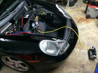

Well I hooked up a set of gauges and after sitting for almost 2 weeks since I charged the system....it's showing ZERO psi. :( Obviously have to find the leak and fix it before I can troubleshoot any further. Siiiiigh.
Fuse D6 and Relay #18 are good and 12v is coming to Pin #4 on the pressure switch. And there is nothing on Pin#1, likely due to the system being unpressurized.
The saga continues...
Just an update... I replaced the o-rings in the condensors and on the receiver/dryer. I am also switching to a compressor for a GTO. The pressure ports on the compressor are on the side instead of the back, and it is new/remanufactured. I don't think the compressor that was on there was leaking, but just something I wanted to do anyway because the lines were really close to the exhaust manifold with the adapter fitting on the back of the F-Body (Camaro/Firebird) compressor. Hopefully will have a chance later next week to hook everything back up and vacuum the system down again to check for leaks....
Stay tuned... :)
Got the GTO compressor installed, needs a longer belt, and a different adapter than what I had...always something. I swear when the AC is working like it should I'm gonna pop a bottle of champagne. :-D
2 o-rings that connected the custom lines to the factory lines were the culprit! :oops: I guess I didn't check them thinking they were on good when I attached them initially. they were damaged at both tops on each line so no liquid/oil was present upon inpsection. System is under a vacuum now and will check it in the morning and then hopefully service it and continue trouble shooting the compressor control circuit. I was getting ready to replace the evaporator and not looking forward to that. We'll see in the morning, hopefully the gauge hasn't moved. :wrench:

Alllllrighty then. Just serviced the system with 2lbs of freon (3 12oz. cans). With the compressor jumpered and engine at idle, cooling fans on high, it is blowing cold. :thumbup: Used vac pump to suck down for 15m before servicing.
