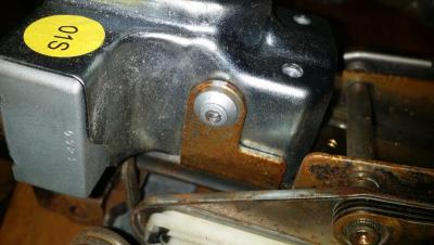

On that note, some pictures for people that work on this part in the future.  The lock is removable fairly easily.  The manual is not correct when it says that none of the parts are removable.  You may still need to buy a whole new or used assembly because the parts aren't sold individually, but I'll show you how to get it apart.
See these knobs?  They're screws with no heads.  They aren't in very tight and can be removed with vice grips, or by using a dremel tool to notch them for a screw driver.

Remove those, then wiggle the cover off.

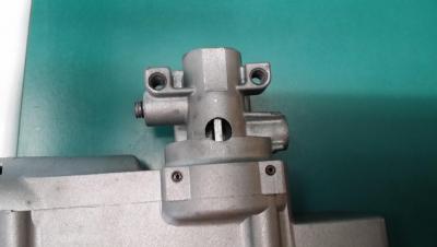

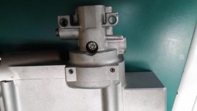

The lock has one coupling bolt that is only accessible from below when the lock is unlocked.  Once it's unlocked (retracted) there is a hole here:

Unscrew that, and the ELV or steering column lock will come off

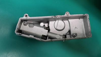

The lock is 4 parts.  There is a metal cover, a back plate, a circuit card, and a motor/gear assembly.  The back plate pops out if you get a chisel or flat head screw driver between it and the rest of the case.  The card slides out from there.  This is the motor/gear assembly.  You can test it with a 9v battery to make sure the motor and gears are still good.

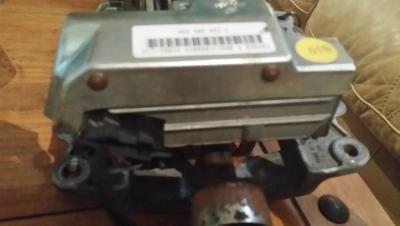

The answer so far is yes. Here's the upper steering shaft and column with the switches and steering wheel removed.  The ELV has been removed from the column, although I did some damage in the process because I couldn't tell how it came apart and there was nothing online about it.

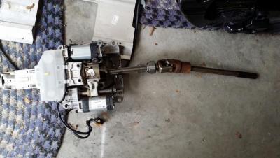

This is the top of the lower shaft and the rubber boot still installed.
post-53634-0-96871000-1431895117_thumb.j
They came apart fairly easily, so I anticipate the new one will slide right back into the boot/lower shaft coupling.  As long as that works then it's possible to skip the whole "disassemble and remove half the exhaust header" step.  Had I not mangled it in the process of learning how it was put together I could have attached a replacement ELV directly to the underside of that column without removing it.  It would have still required the dealer to reprogram it, but it would have been a 1 hour job.

Just completed this repair myself recently.  The issue is the Audi steering lock actuator that locks/unlocks the steering column.  The part in the first picture in the original post. This is the only part that fails and needs to be replaced, but is not available as a single item.  A new un-coded column with the actuator needs to be purchased and installed.  I found an unused Audi A8 column that some parts warehouse had sitting in their basement for $300.  $1500+ from the dealer.  Again, the only part that needs to be replaced is the lock/unlock Audi actuator.  The problem is the actuator mounting and the screw that holds it to the column assembly.  The actuator slide goes over the screw so depending on when the actuator fails the slide can be over the screw or not. 4th and 5th pictures above.  Depending on your electrical skills, you can move the slide by taking the actuator apart (picture 6) and applying 12V DC to the 2 motor terminals and move the actuator.  The PC board will still need to be replaced though as this is where the control to move the actuator motor comes from. Once you replace either the actuator or the upper part of the steering column (both sections of the column do not need to be replaced), the new Audi actuator does need to be coded to the kessy module.  My dealer had some problems doing this and it finally was accepted on the 3rd try so make sure they don't give up on the first failed attempt.  The Audi A8 actuator I used was a version E and my original actuator was a version C meaning there were 2 upgrades by Audi to these actuators.  This is actually a common problem point in Audi A6 and A8 cars with these steering columns.  Be aware that yours will probably fail too.  2 weeks after this repair the LCD main display wend dim.  Porsche wants $2000 for the replacement dashboard display.  I repaired it with a new $20 transformer and a voltage regulator.  Not a hard job, but a PITA to desolder/resolder.  There are a few repair services that will charge you $400+ for this repair that requires $20 in parts and maybe an hour of work once the display is out of the car.
