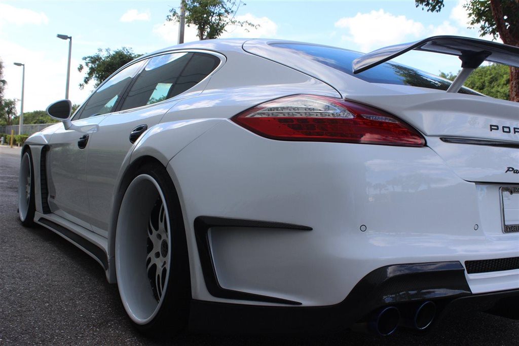

I have a 2010 panamera turbo with 56k miles with a tuned file with 622 hp; use as my daily driver; been running great and no issues; then today after leaving appt I start and starts idling very rough; no lights come on; I was low on fuel yet no indicator light; drove to station fine and filled up.
Ran some more errands and no issues; then leave last one and as I'm driving stop and go engine comes on, psm light and start/stop disengage light all appear; engine running very rough.
Pull over and turn off and restart; roughness goes away after couple minutes and I drive back to office with all the lights still on; leave office later and all lights are off and runs fine.
Any ideas would be appreciated
