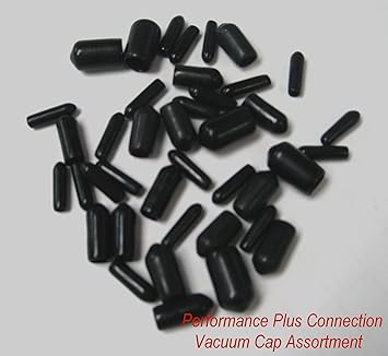

If you measure the line flare, you can actually get little rubber caps for a few cents each that are supposed to be for capping off unused vacuum lines that look neat and do an excellent job as well:
But a screw in a hunk of rubber hose also does the same job....................
