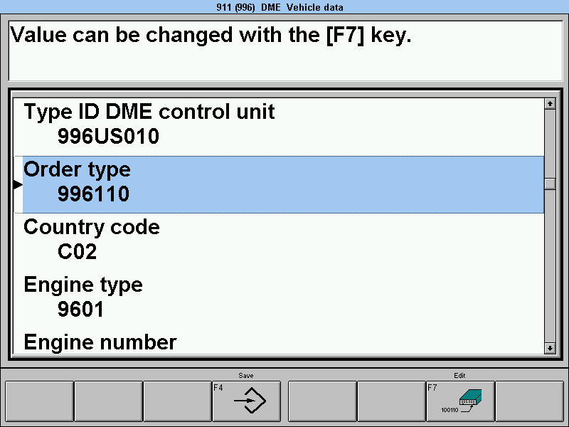

After extensive searching, I still have not been able to locate a step by step explanation for how to use PIWIS/PST 2 to reprogram the 5.2.2 DME from 2.5 to 3.4.  I'm doing an engine swap in my 99.  I have all the immobilizer codes and my DME ends in .04, so should be reprogrammable.
Can anyone provide the steps?
Is it similar to the process described here (courtesy of pelican parts):
  • Connect the PST2 or PIWIS tester and select model 996 and the DME module
  • The only option available to you will be to reprogram the DME
  • Reprogram the DME using the immobilizer and DME programming codes. Use the codes that you received from your dealer, and enter the same values for the old and new codes when the PST2 requests them.
  • After programming, enter the vehicle data tab
  • Recode the model type to 911 C2 cab , use 911310 for North America, or 911311 for Rest Of World (ROW)
  • Back out to the original screen and perform a complete control module search
  • Enter the instrument cluster tab, and change any coding you would like (cruise control, On Board Computer, cabriolet set, etc)
  • Exit back to the original screen
  • Recode back to your original 986 type using the current DME and immobilizer codes you used previously.
If so, what "tabs" need to be modified to get the 3.4 program?
