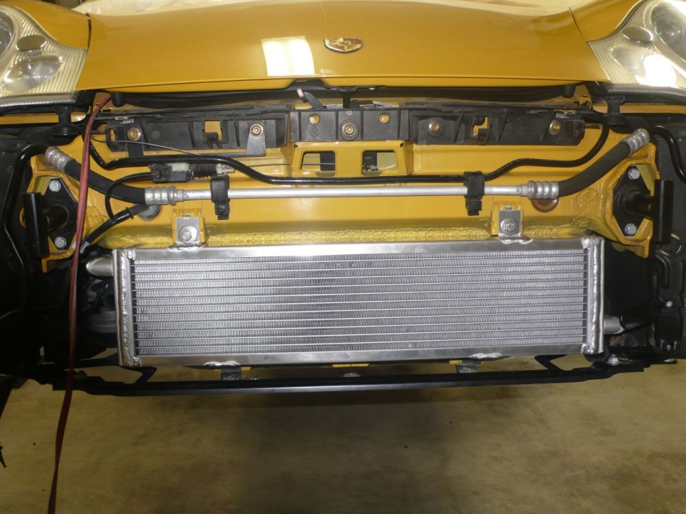

I had the surge tank hose come loose from the left radiator, so I made the repair and tried to use the Airlift tool, but because there was a residual about of coolant left in the system it wouldn't work.  I filled the system up the best I could, drove the car and it over heated, then refilled and got it over filled and it over heated again.  The system is very prone to trapped air and unless you completely drain the system and use the Airlift tool to fill it I think it's problematic that you're going to have trapped air for some time.
The rub is getting the system drained, I hate messing with good hose connections and I don't know which hoses would get the job done.  Maybe removing the hoses from the aluminum water pipes under the car.  Also, the Porsche factory 3rd radiator is for an oil cooler, I had one made which is larger than the stock 3rd oil radiator.  I'm not sure what the difference is between the oil and water radiators.
If you want to know about a third radiator install I covered it here:
This was back before the days of Uview Airlift so I had to drive the car for a few minutes then top up radiator - this took a couple of days. So, Uview Airlift is definitely the best choice.
