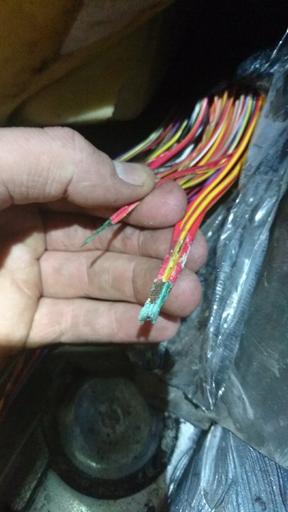

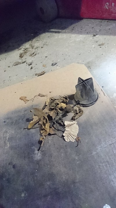

Update.
Transmission codes is sorted. This was a bad wire inside the transmission connector under the car.
Also resoldered all wires both sides under carpet inside car. The foam was soaking wet due to clogged water drains in front of car. it was maybe 10 of these corroded wires.
