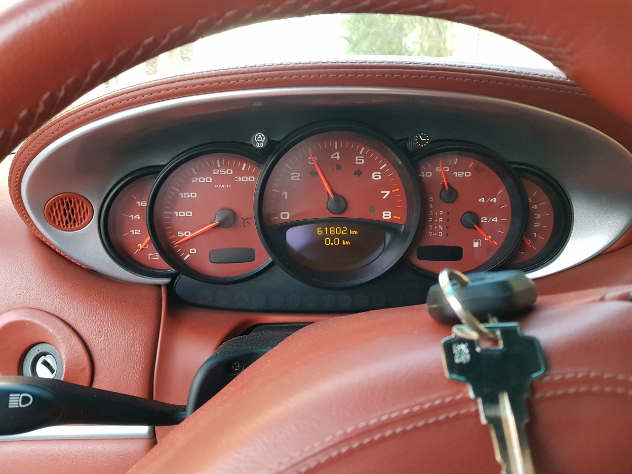

while I was driving all gauges stopped working and frozen even if I get the key out, removed - terminal for more than 30 minutes still the same
called Porsche dealer and told me that we never faced this issue before lol maybe I'm the only one on this planet

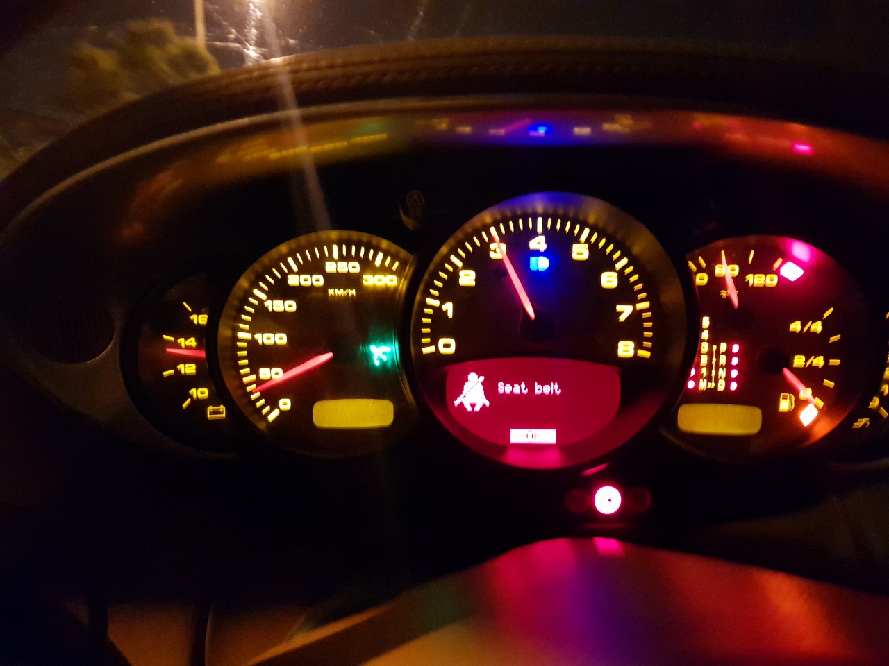

as you can see in the picture while driving , high bean light indicator came on , cruise control light indicator came on , Speedo frozen , rev frozen , oil and fuel frozen and lights on ?
all gear lights is on ?

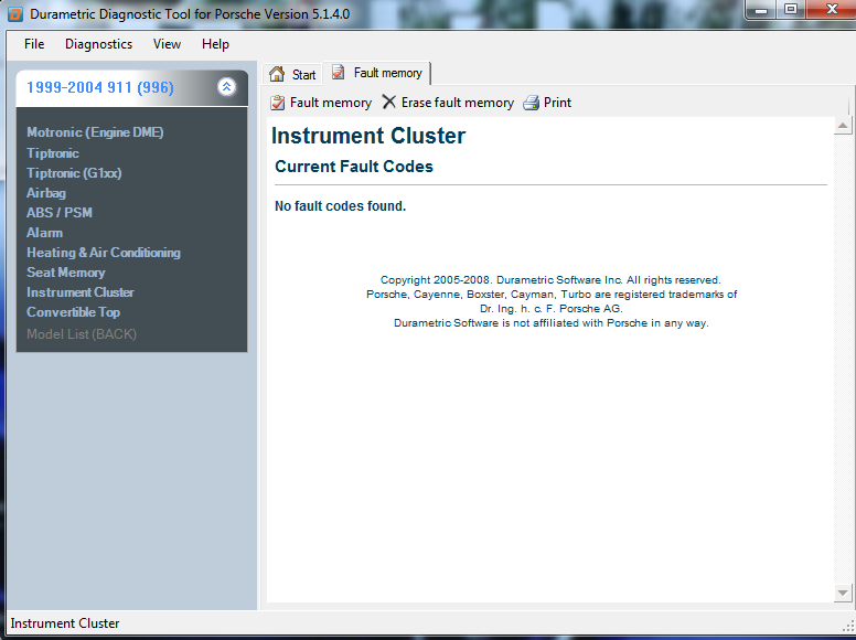

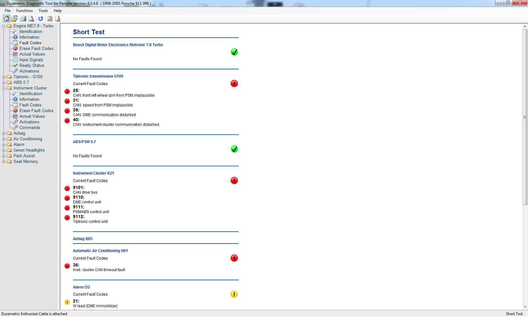

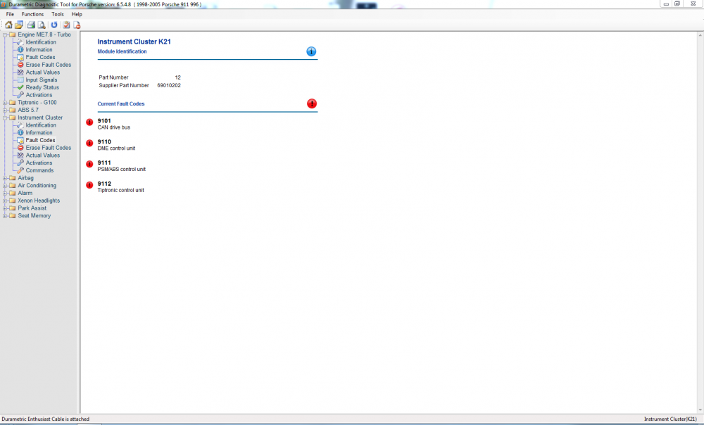

I cleared the faults only 3 remaining , the gearbox fault is normal due to upgraded by MKB, Germany
The last picture is the main fault

When I unlocked the car and opened the door , the digital km and the digital outside temperature came on but once I inserted the key turned it to position 1 the display gone ?
I think there is a ghost inside the car lol
