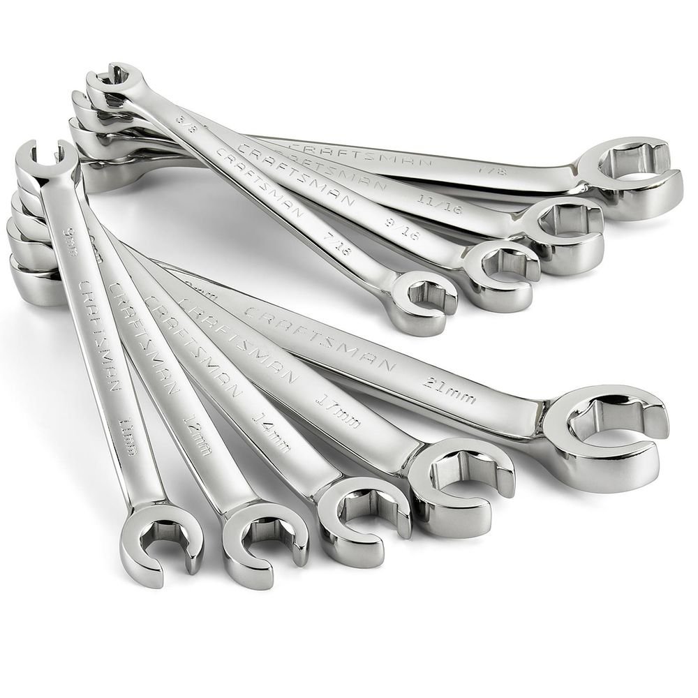

To remove the calipers for painting, is a special tool required ?
You are going to need a set of metric flare nut wrenches to undo the flex lines:
You will need to buy or fabricate line plugs for each brake line to prevent the system gravity draining while the calipers are off.  You will also need new caliper bolts as they are single use, high temp anti seize compound for the same, and a suitable torque wrench to reinstall the calipers.
