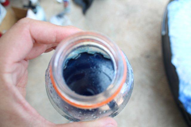

Refilled with Ate Blue, sucked the fluid out (skimming the top), with a medicine syringe, down to below the MIN line. Refilled with Napa DOT 4 and skimmed the fluid again. Refilled with Napa again, all the way to the top, hoping to get the oil to float to the filler neck so I can get at it better. I'll go back out soon and see how it looks. But at this time, there's no sheen on the top. So I'm guessing no oil?
Also, from the photos, the very top layer (1/8"?) is darker than the rest. I'm guessing that's the CHF202. But, looking in the bottle, there's no sheen.
