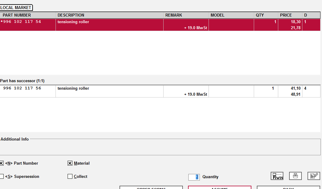

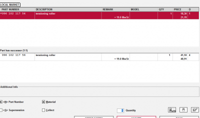

Got a bad belt tensioner roller (can wiggle) on my 98 C2 6speed.

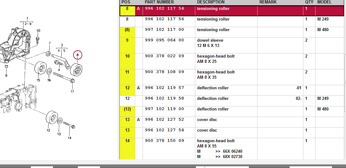

Acoording to PET partnumber is 996 102 117 54 which is replaced by 996 102 117 56 but is for a model M 249 (tip)
Partnumber 996 102 117 00 is for M 480 model which is a 6 speed. Om my alternator I have no free wheel so which roller to order and what is the difference between the two?

I need the one with the white arrow which is the tensioner roller.
Note that my altenator does not have a freewheel pulley as far as I can see.

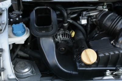

See below picture of alternator wihout cap so this is the confusing part in ordering the correct pulley.
Edited by Rob001
I don't know what you mean when you say your alternator has no "free wheel". The alternator has a pulley on it that is connected to the alternator guts - nothing else. The photo I posted is how your engine looks underneath all of the air cleaner stuff. That tensioner pulley is not attached to the alternator...

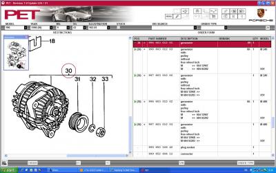

Alternator for a 6 speed (M480) seems to have a pulley with a free wheel lock and a tip (M249) without according to PET.
Pending on which alternator pulley type there are two versions of the belt tensioner roller (not the idle rollers) as shown in my first post.
So what if you have a 6 speed without free wheel lock and what is the difference between the two tension roller partnumbers available in PET?
